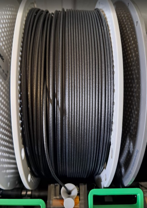

Trying to run this again using PA6 and the filament spool was improperly wound. Jammed inside my printer. Hopefully it didn’t cause damage. Geez I’m tired of all these setbacks.
I cannot extrude any material. I need to take apart stuff to see if something got jammed, broken, worn, etc.
Apologies for the delay. I thought this would have been an easy thing but I did not foresee a bad spool being a problem. :confounded_face:

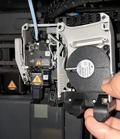

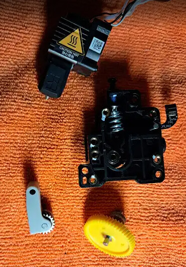

I took apart the extruder and there’s no damage. No blockages. I don’t understand why it won’t feed any filament.
I can’t believe that bad spool totally screwed me over.
I have a support ticket in with the 3D printer manufacturer to get further insights.
Only two things I can think of is the hotend not getting hot enough or the extruder feed gears not biting into the filament hard enough to push it through the hotend.
I’m thinking the second one – the feeder isn’t grabbing the filament. But there’s a spring and tension screw there. I don’t see how it’s not on the filament. I’m hoping it’s an easy fix because it looks like a simple mechanism.
Going back and forth with 3D printer support for several days now. I think I figured it out myself that the jam threw something out of alignment. (Support isn’t really providing anything I didn’t already figure out). The tensioner for the filament is working backwards, but unable to understand why/how.

I just saw your reply about the feeder. On my trashcan Ender 3 the tension was through a plastic lever arm that fatigue cracked, and the brass gears were dulling down through use. I assume yours is a better design but they probably do all fatigue from the software constantly feeding and retracting filament.
New extruder assembly arrived and I just installed it. Same issue. I’m so fucking frustrated. Support has been subpar.
@kip-ft The machine doesn’t have that many hours on it but I’ve done the required maintenance. Nothing is worn at all according to support that asked for photos of everything. :face_with_steam_from_nose: :enraged_face:

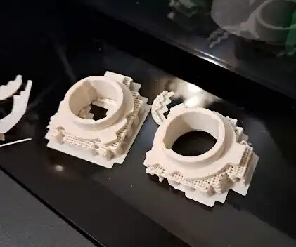

Test print went well! What didn’t go well is the support tends to stick to the actual part.
So I have to tinker a bit more. Glad for the holidays the next few days where I don’t have to go anywhere.
