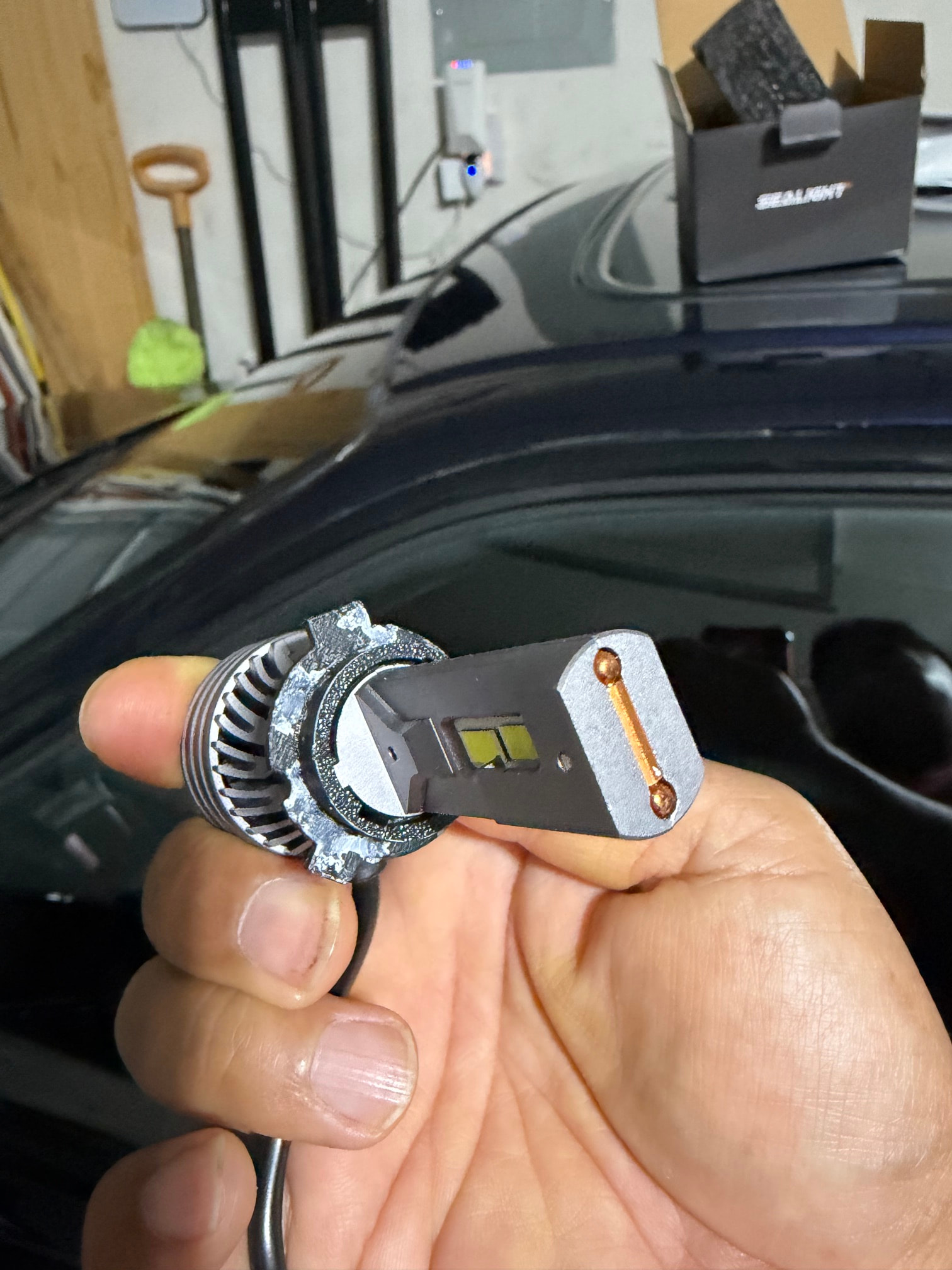

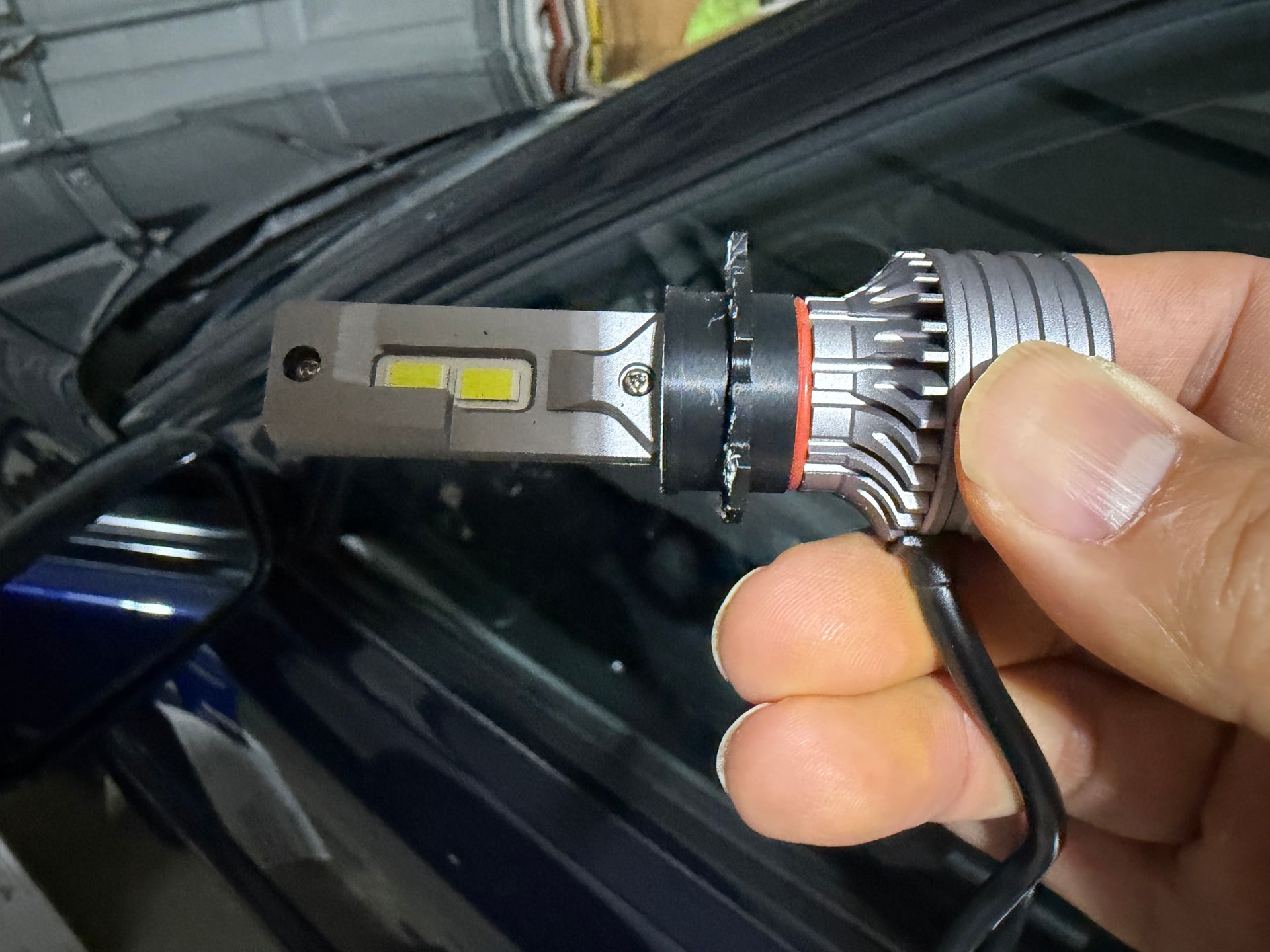

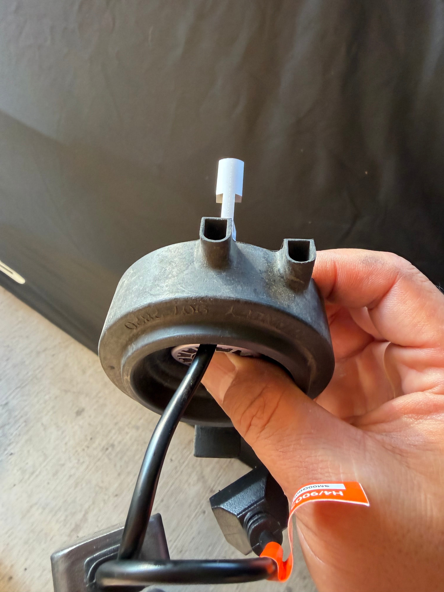

  • The smaller lip edge mates with the bulb, and the fatter lip on the adapter mates with the headlight housing.
  • There will be some white material left on the adapter part. This is the support material necessary to reduce the chance of warping while printing. You can leave it as-is or sand off if it bothers you (but it is very time consuming).

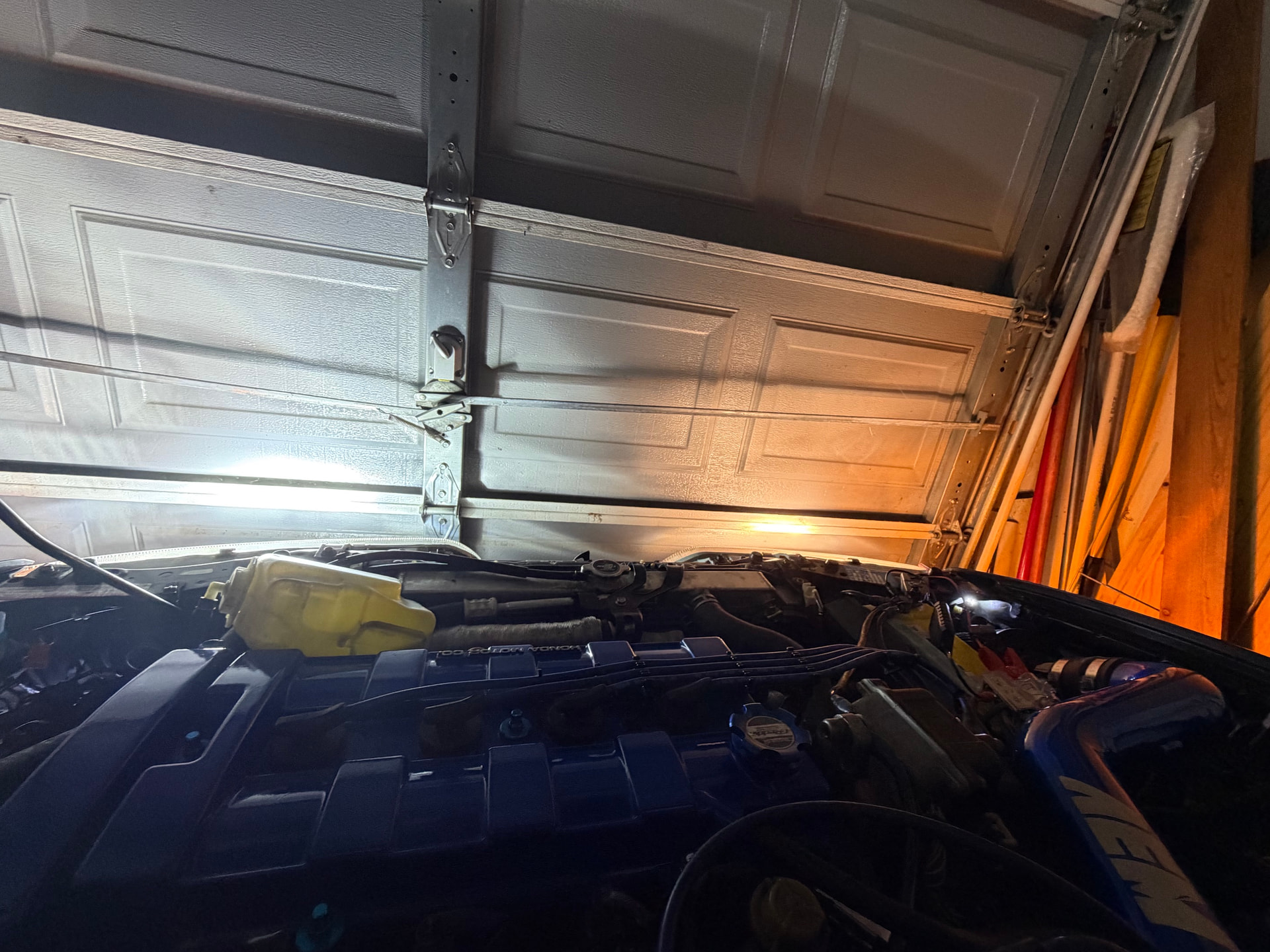

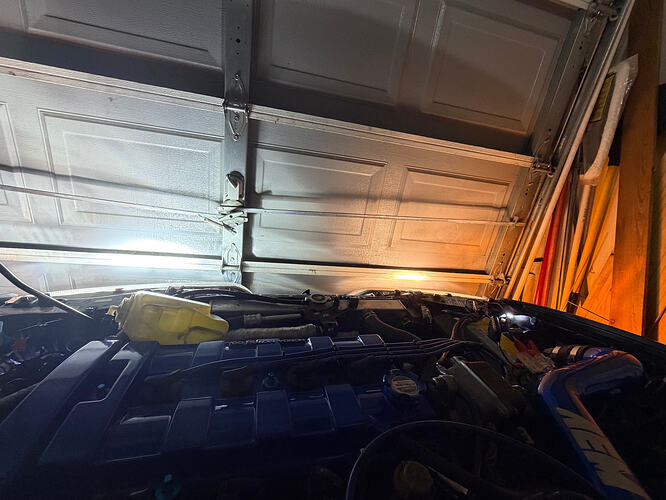

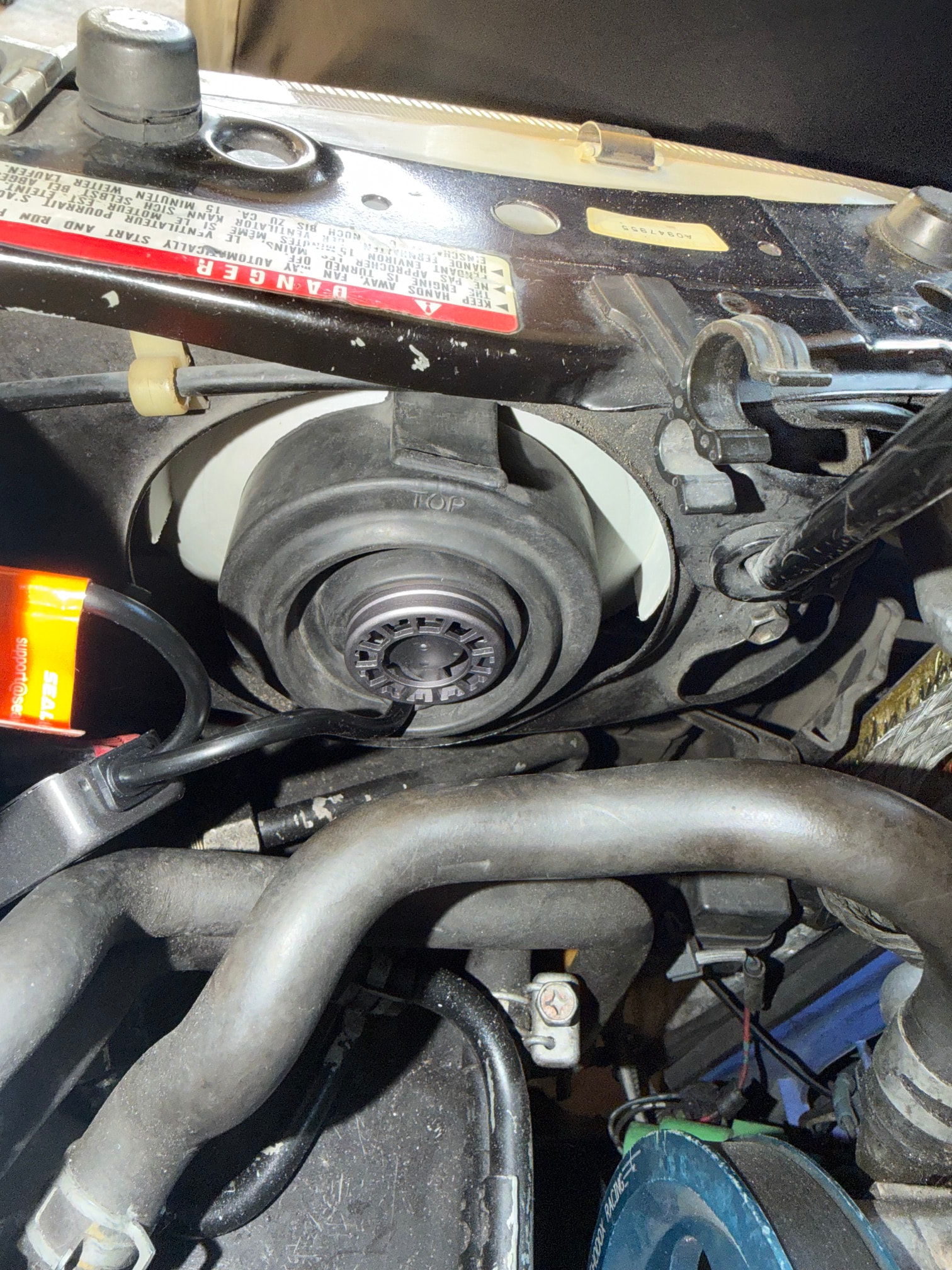

I was able to install the adapters and test yesterday. The adapter has good fitment on my bulbs. I was able to reuse the dust covers, which is a plus. After that I went for an hour drive after the sunset. Engine bay temps were about 145F next to my battery. So far the sockets look fine.
