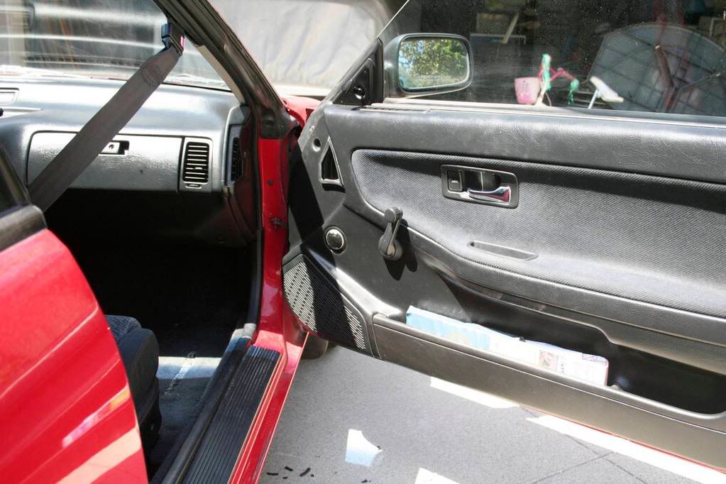

back from the dead, but i thought i’d contribute to this thread with my placements:
i too tried it higher towards the mirror, but it sounded as if the music was coming from more than one place, which i dont want.
