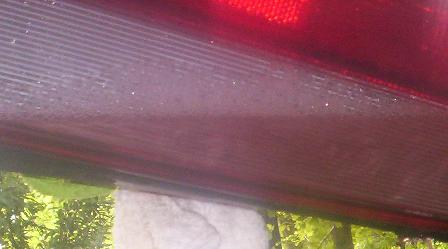

I went ahead and broke down to mod the tail lights… It worked great. Used hot water and Purple Power. cleaned em up a lil, and even did something else besides taking the pink out… Can you tell what it is?! Took me about an hour and a half… Even got muh girl to help me out! :slight_smile: Check out the pics… I’ll rate this forum a 10! The shit looks sweet!
no, i don’t see what else you did. inform us
I painted the vents on the sides… went from black to silver…
