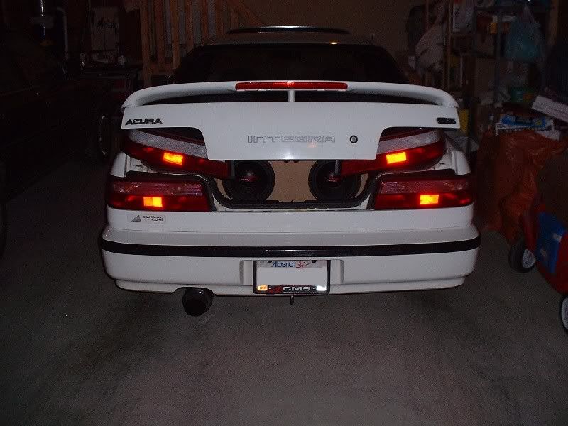

hey, I’d love to see some night pics with those lights installed … like backup lights, brakes, flashers and stuff…

hah! man that was sooooo easy, just finished reinstalling them :smiley: :rockon:
