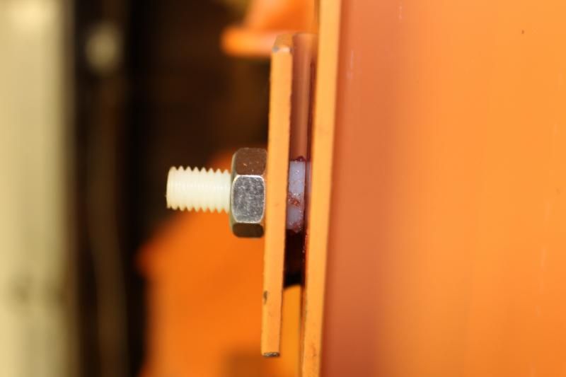

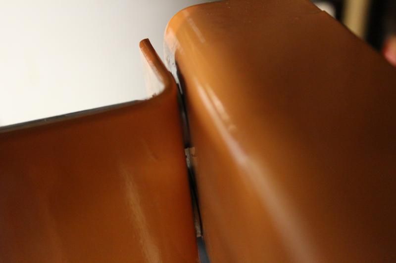

Keep the updates coming. I am also in the process of replacing my bushings with the same press. Curious how you make out with the POR15 & powder coating as well. I wanted to share the below pics because you can actually improve that press in a few ways. 1. Fill the gaps with washers so it won’t flex (since you can weld, might as well weld it all up too) 2. Use Nylon Bolts to center the main arm. Definitely a great tool to have.

I like that idea of reinforcing/centering the press! I’m definitely going to do that. Thanks for the pictures!

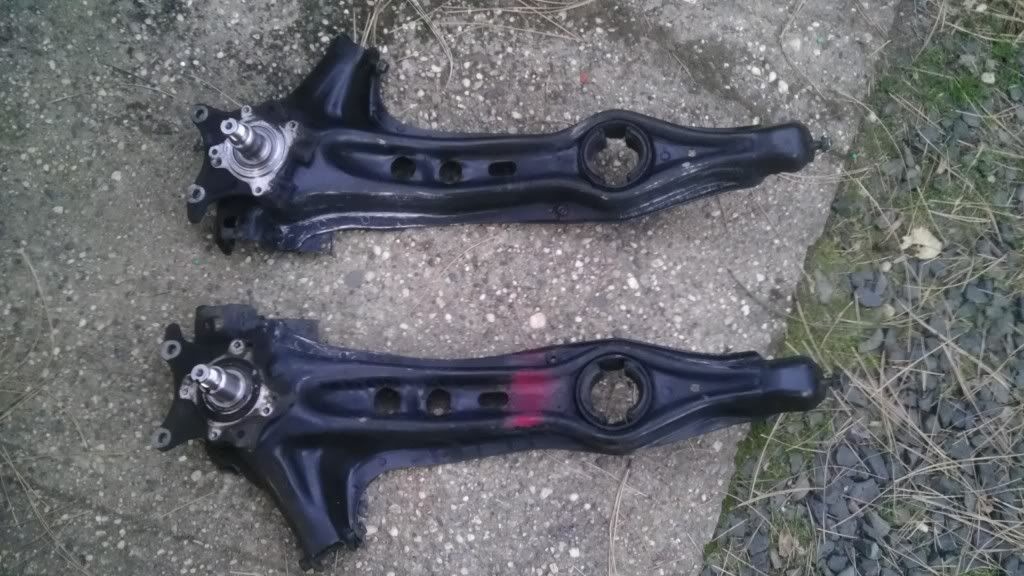

Tore down my RTAs today. You wouldn’t believe I cleaned them but I did. They’ll need a lot more time to get them clean enough. The bushings were shot!
What bushes are you going to replace them with? Blox spherical maybe :rockon:
I’ll be using hardrace RTA bushings. I don’t like the idea of spherical bushings on anything but a dedicated track car and I don’t care much for blox either. I’ve never had a bad experience with anything of theirs but I’ve heard stories.
Yeah for sure… you don’t want spherial RTA bushings on the street car.
HardRace, Mugen or OEM. With the price and quality of the HR bushing, you really can’t go wrong. I wouldn’t even consider Blox.
