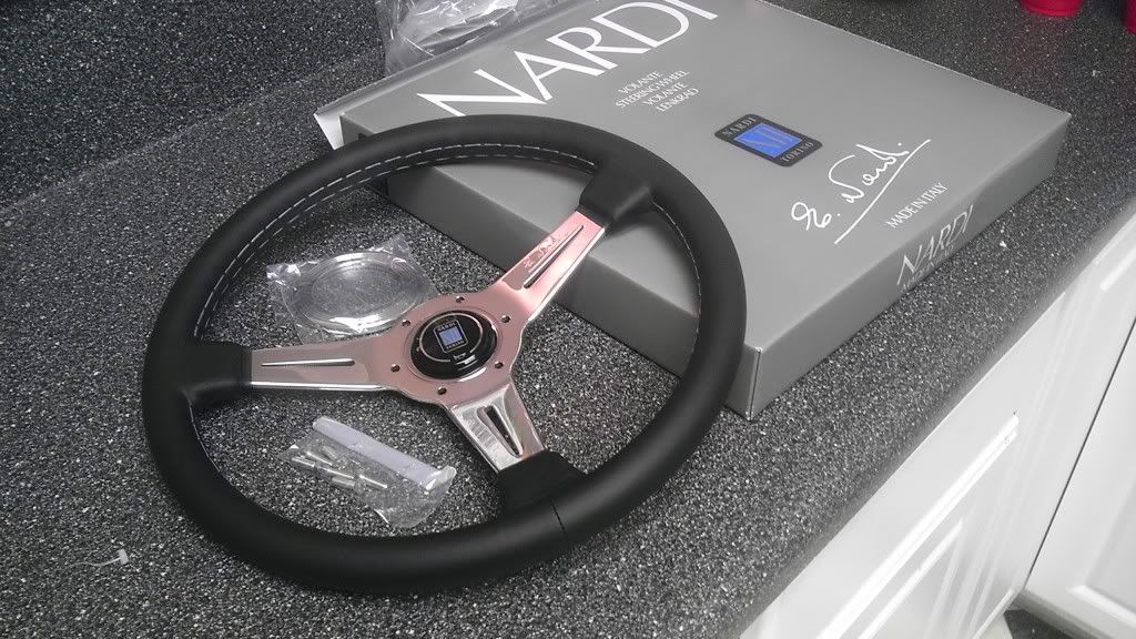

Came home from work to a birthday present from my girlfriend!
Dang, nice gift! It has a “classic” styling about it. Good stuff bro.
Thanks! I love this wheel. Had my eye on it for a while and she ended up getting it for me!
:up: really nice wheel
Thanks!
nice steering wheel, great g/f!!
Thanks! It’s gonna go great with my recaros! Hopefully picking a set up soon!
sick ass steering wheel!
Your girlfriend has good taste in steering wheels haha.
You lucky guy I wish my wife is like your girlfriend she’s a keeper.
Thanks guys!
