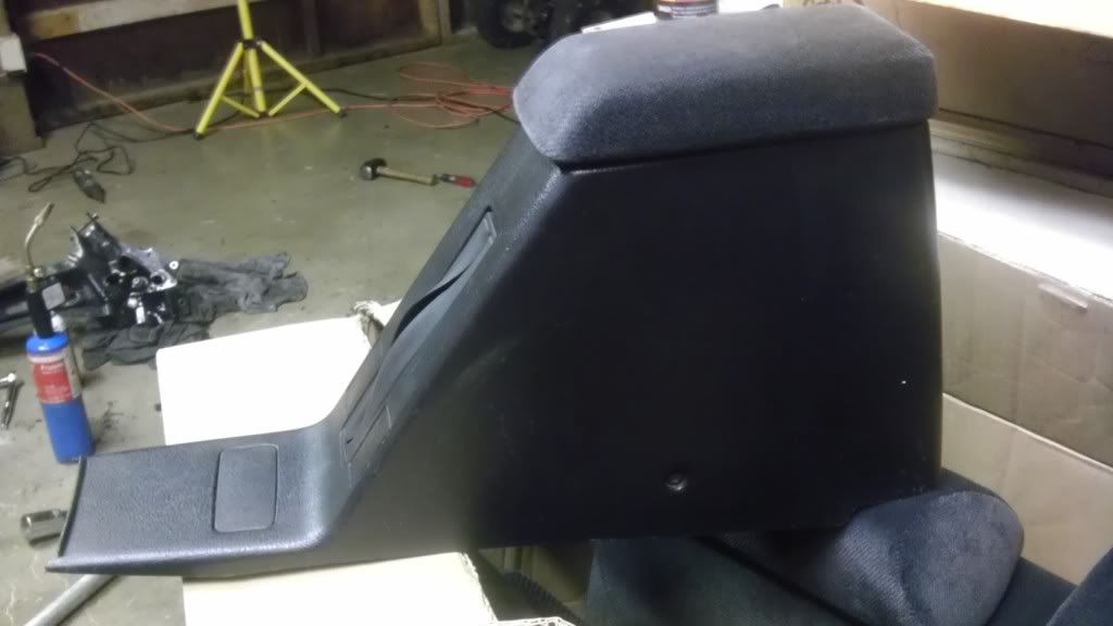

First of all a huge thank you to redrocket for hooking me up with a great deal on a jdm/cdm armrest!

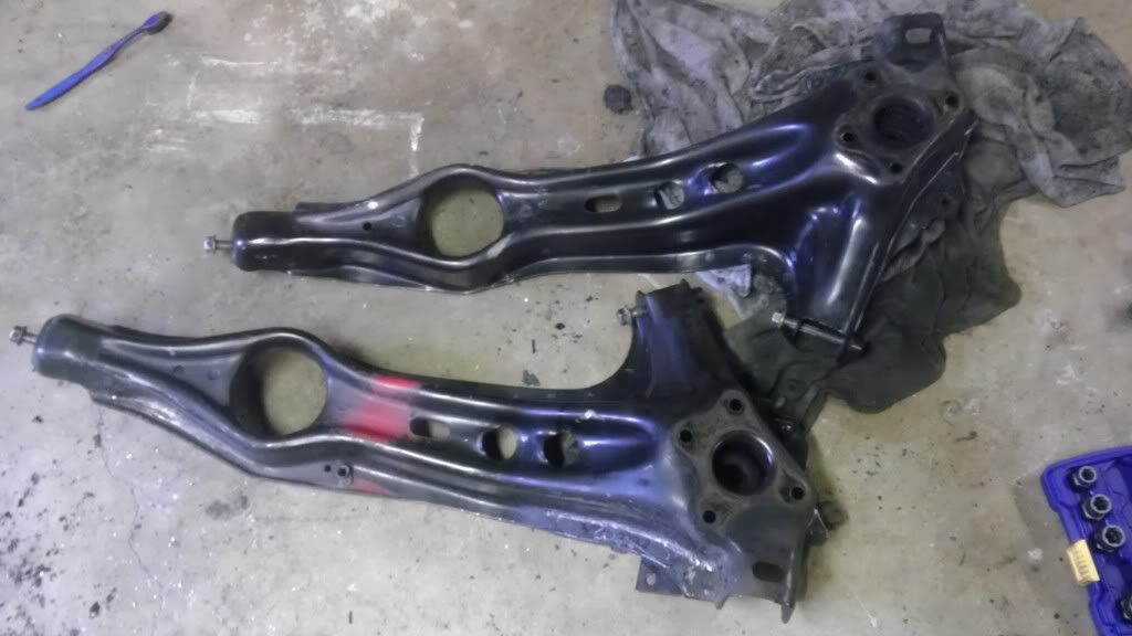

I got the rest of my suspension ready to go to powdercoating. I made a few phone calls and have a couple shops lined up to get me quotes once I get a chance to take everything down to Chico. It’ll be a little more expensive than I thought because I’m going to have it all media blasted first but it’ll be worth it. Here’s my completely naked trailing arms

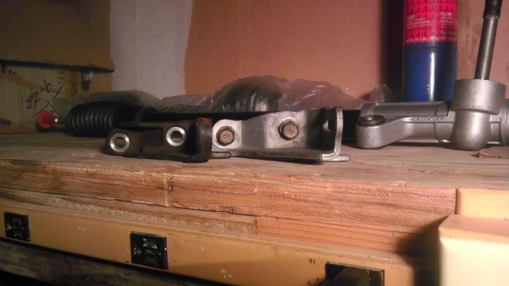

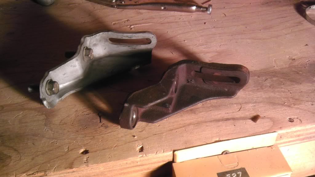

Also finally made time to pick up a gsr upper alternator bracket from a local.

Lemme see a pic looking from the bolt-head view… Interested to see how much it contours…

Are you talking about the upper alternator bracket? If so its not so much the contour. It’s more the fact that the ls one has more material before the “lip” that was interfering with the IM studs. I’ll get you a pic, its hard to describe
Ohh, just less material… that makes sense… I wasn’t sure if it was contoured or just ‘thinner’.
No worries on the pic, I understand… I felt my setup ny hand, and my brothers b16… I can definitely see how a millimeter or two can make certain setups hell lol. Regardless, nice to see it sorted!
Well I took a pic but its still hard to see what the issue is. :shrug:
Basically though, the bolt holes on the LS bracket are higher off the workbench than the GSR bracket which makes it stick up too far and interfere with the intake manifold.

If you can find a powder coat place that does their own prep then you’ll likely save some $$. Generally they’re used to having to prep materials so that should be included in the cost. If you’re shopping blasting companies though you should also take your trans case to see if you can get it blasted or tumbled. I’m sorta kicking myself for not doing this. Same goes for the block/head but I think you already have the engine together, right?

Colin- yeah one shop gave me a quote for just powder coating and no prep and it was significantly lower but the other places I called had prep included in the price. I just hadn’t taken it into consideration when I was thinking about it at first.

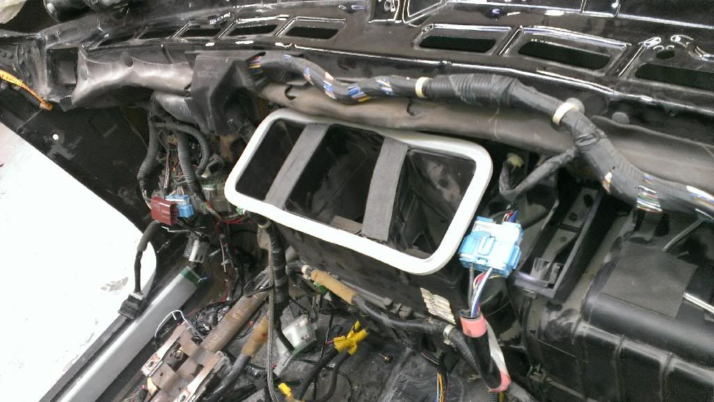

Oh, and when you get into re-installing your HVAC stuff make a stop at the hardware store for some weather stripping, when you take a closer look at all of the components you’ll realize ALL of the foam seals need to be replaced. Everything under the dash gets really worn out quickly. All of the wire ties holding my wiring to the dash were amazingly brittle, way more brittle than even the engine bay ones.

Oh, and when you get into re-installing your HVAC stuff make a stop at the hardware store for some weather stripping, when you take a closer look at all of the components you’ll realize ALL of the foam seals need to be replaced. Everything under the dash gets really worn out quickly. All of the wire ties holding my wiring to the dash were amazingly brittle, way more brittle than even the engine bay ones.[/QUOTE]

Colin brings up an excellent point with the HVAC foam seals… we recently put the dash back in my brothers EK and the OEM foam was so porous and caked with dirt… I imagine there was quite a bit of air loss going on in there. We yanked off all the old stuff and got new (more dense) foam tape from Lowe’s. The dash sits so much nicer on the vent openings now… I can only imagine how bad our even older cars are.
