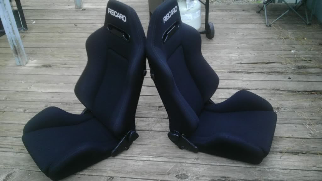

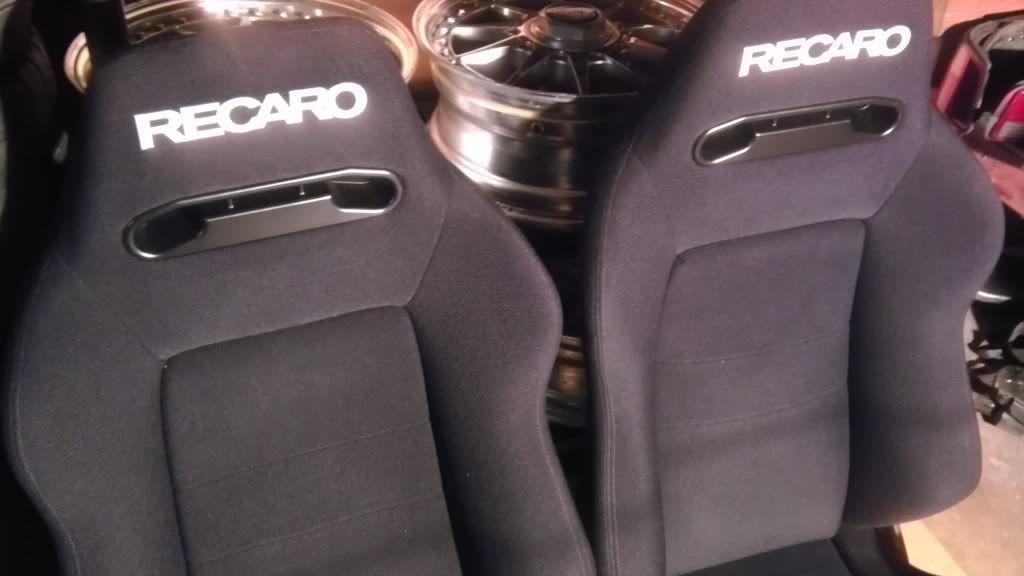

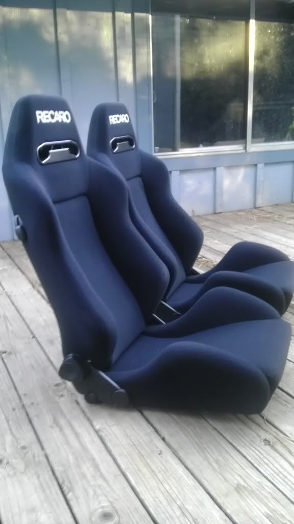

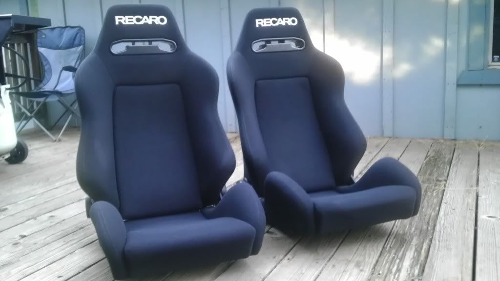

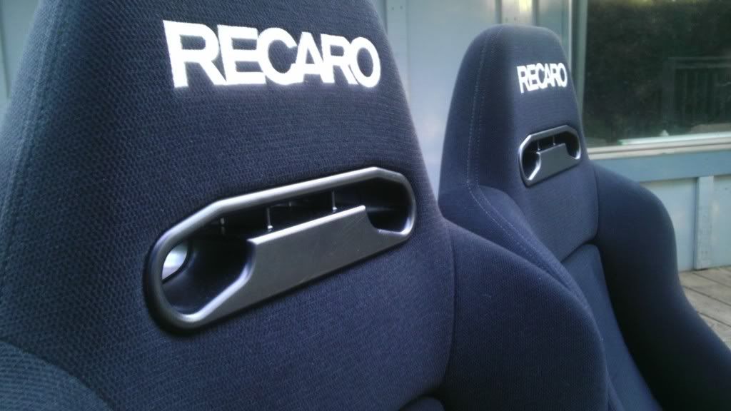

So here’s my update… I picked up my Recaro SRDs today. I seriously love these seats. Not only do they look great but they have to be the most comfortable seats I’ve ever sat in and they hug me just perfectly.
I wish I had better pictures. My phone camera sucks. They are MINT though!
[QUOTE=rollinmyda;2309110]
I wish I had better pictures. My phone camera sucks. They are MINT though![/QUOTE]
I didn’t want race seats in my car but those I actually like. are they blue? might make me change my mind.
[QUOTE=Colin;2309056]
did you paint the bolts? Where’s your build thread?
No they’re black. A really deep black too. I’m not sure why they look so light/blue but I blame it on my camera.
They are kind of a race seat but believe me they are sooo comfy compared to our stock seats. I wouldn’t have wanted all out buckets for anything other than 100% track use either.
Those look basically like ITR SRD Recaro’s… Sooooo comfy!
Congrats man. This is surely coming along nicely.
Nice choice on the seats. Are they the same thing as the jdm ITR Recaros just not red?
Thanks! Yeah its basically the same exact seat but without the red stitching and the RECARO is at the top instead of below the holes. Minor differences though. The black and red wouldn’t have worked with my paint scheme.
The black looks awesome… not super flashy.
They hug so nicely… Fuh… regretting selling mine lol.
You sold yours? Why?
Yeah man. Ended up in a position where I could use the money more than the seats so I said to hell with it.
As picky as I am though, I wasn’t completely happy with the condition of them, being ‘used’ and all. After a good cleanup they looked great but… Ultimately I’ll be happy to get some NEW seats. Since the teg isn’t going anywhere there’s no rush as far as seats go.
Builds and pics like this make me itch for them though! Gah!
What are you doing as far as brackets? Definitely keep us in mind, with a lot of pictures and measurements, etc… :wink:
Well that sucks. You barely even got a chance to enjoy them but I definitely know how that goes. I’ve gotten rid of a few things I would have rather kept but just gotta remember that they’re always replaceable or even upgradeable! Sounds like you’ll be doing the latter. :up:
