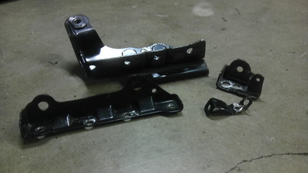

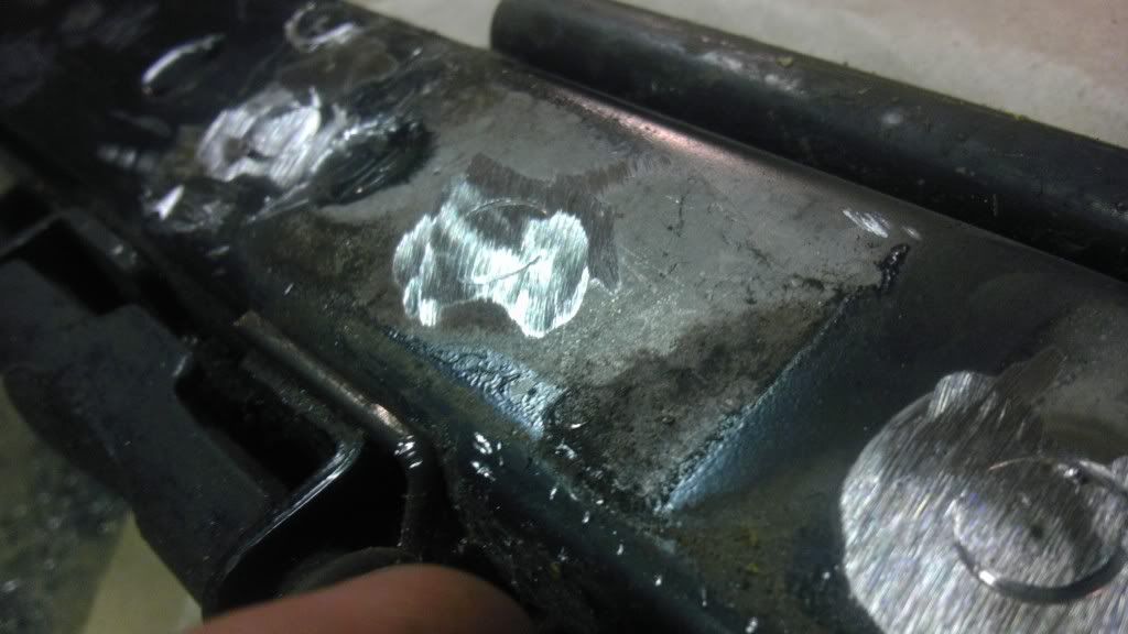

Worked on my seat rails a little today. I didn’t remember to take pictures of removing them but basically just unbolted them from the seats and evaluated what I was going to need to do. I had to start by drilling out the spot welds holding the upper tabs onto the seats. There are 2 pieces on each side, 4 per seat, so 8 total. Here’s a picture of the pieces removed from one seat.
Which leaves you with the tops of the rails looking like this…

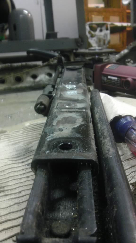

The remaining material from the spot welds has to be ground down so the top is flat and smooth

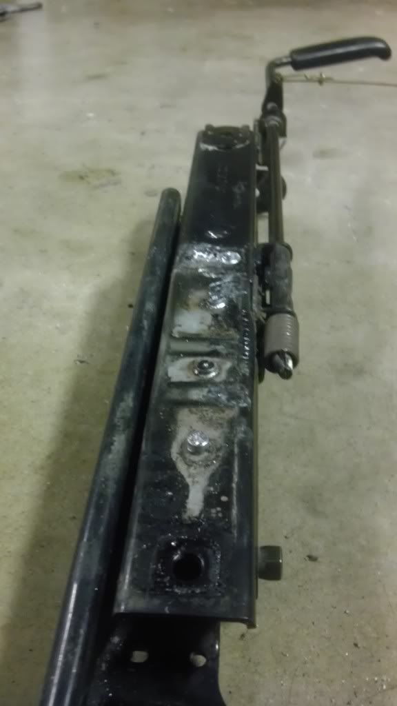

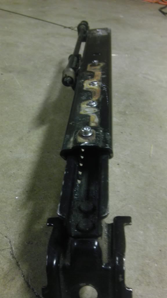

Then I bolted them in place to take some measurements. From here I’ll be welding some pieces of metal onto them so I can bolt the seats to the rails. Currently don’t have my welder or the metal I’ll need so its going to be a while before I finish them but here’s where they’re at

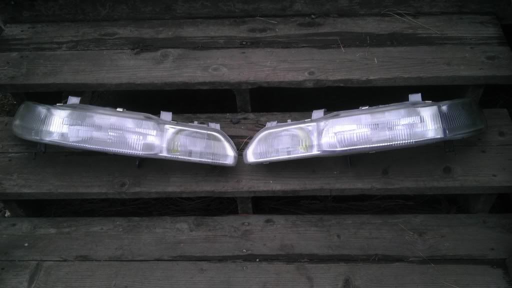

And the pics of the one pieces I promised

The headlights look like they are indeed as clean as can be. And the seatrails look like they won’t pose a problem at all. :up:
Yeah I just hope I can get a low enough seating position with the stock rails. They’ll be a little taller once I’ve added the necessary metal but hopefully not too much. I never asked but how were your recaros mounted? Were you using fixed position rails, aftermarkets with sliders, or did you fab something up too?

You did your rails the same way I did mine.
My recaros came with the EVO 2 sliders which are really tall but removing the “feet” from the DA rails made them sit pretty well.

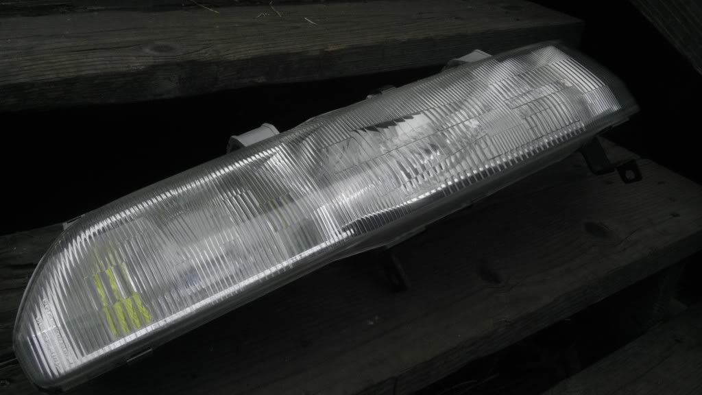

Btw check out the new pics of the headlights on my thread I finished the damaged passenger light.
The lens is fully repaired and I fixed the hole in the bottom of the housing you sent me.
I should have pics of the finished fully cleaned up and sealed passenger light.
I can’t tell in your pics though, are your fog bulb guards (the metal square piece between the bulb and the lens) or whatever they are called removed?
