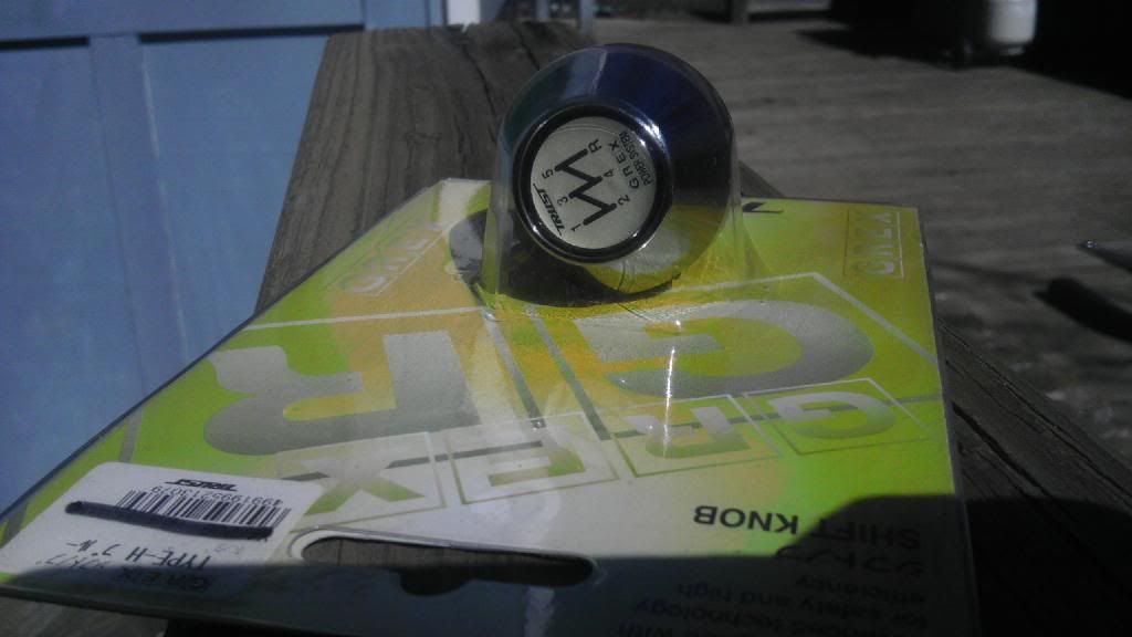

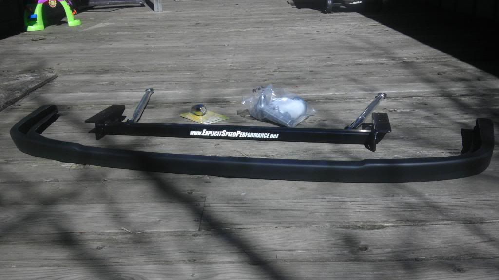

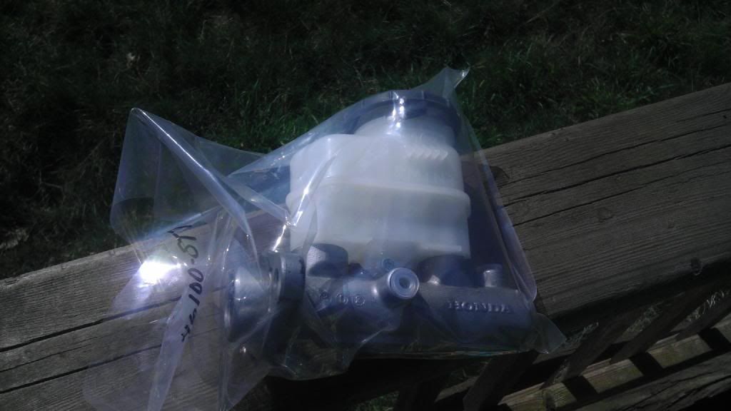

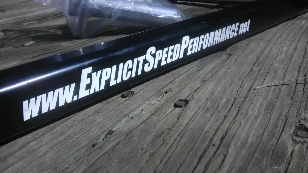

Since I’m posting in here anyway, here’s a couple parts that have come in recently…
Jdp oe2, esp traction bar, OEM ITR mc, greddy shift knob

What’s the story with that JDP lip? I thought they only made them in carbon, and that one looks poly/plastic or maybe it’s just painted already? Mind if I ask what it cost you? They don’t have pricing on the site. I’ve been thinking of just getting the fake JDP OE1 since it’s not worth it to buy a nice CF piece that I’ll likely just destroy soon anyway. But if JDP now sells them in plastic or fiberglass I might buy from them.

As for the jdp lip, it is fiberglass. I believe John gives you the option of ordering anything he stocks in fiberglass as opposed to carbon fiber. I’m planning to paint match it anyway so the carbon finish didn’t matter to me at all. It was about $270 shipped to me compared to the $320 for the carbon fiber version so not a huge cost savings but cheaper. If I was planning to run a dedicated track lip I’d probably opt for the knockoff lips because they’re a lot cheaper.

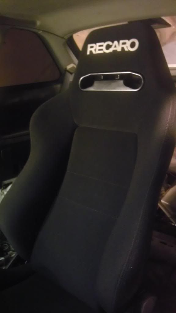

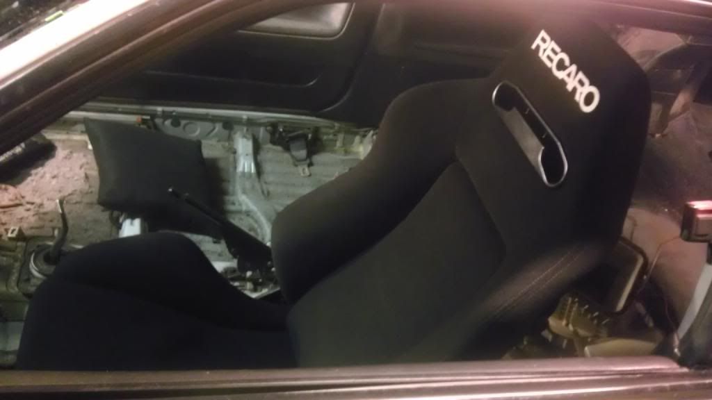

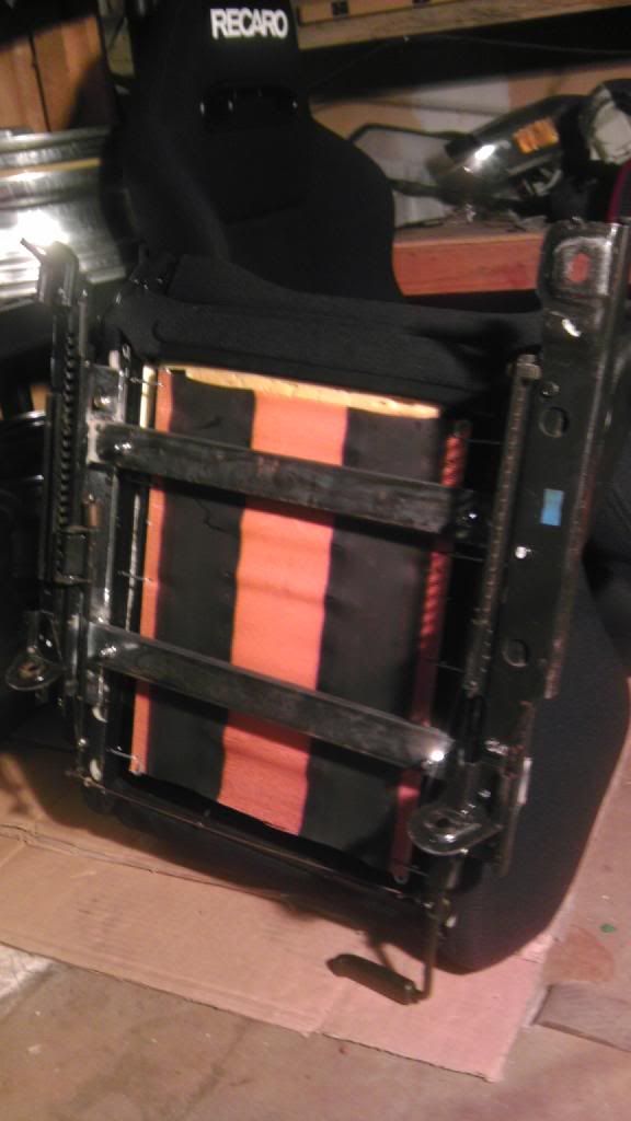

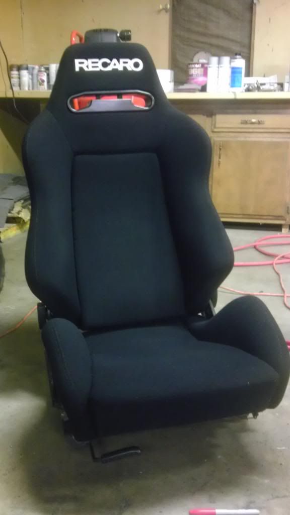

So a bit of an update on my seat rails. The drivers side is not done but its tacked together and so I wanted to mock it up to make sure everything was going to work with the seat and car before spending more time on it. Seems like it’ll work great. Height, adjustability, and levelness are perfect. Time to finish them up!
