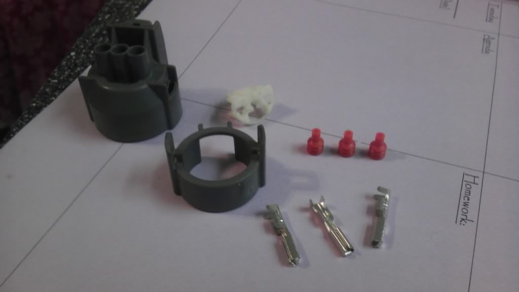

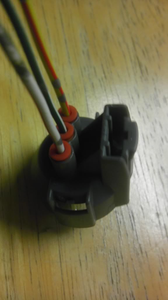

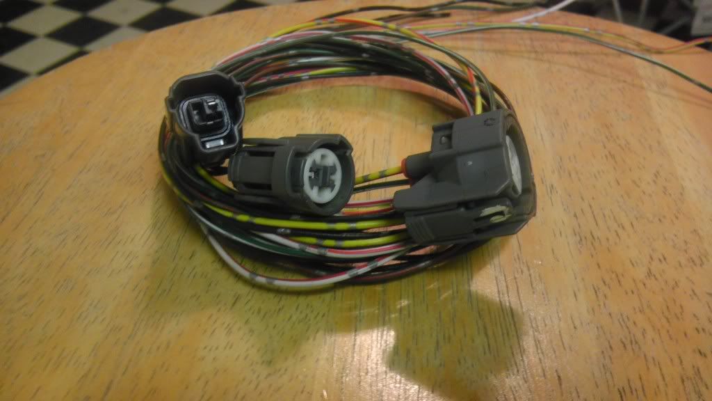

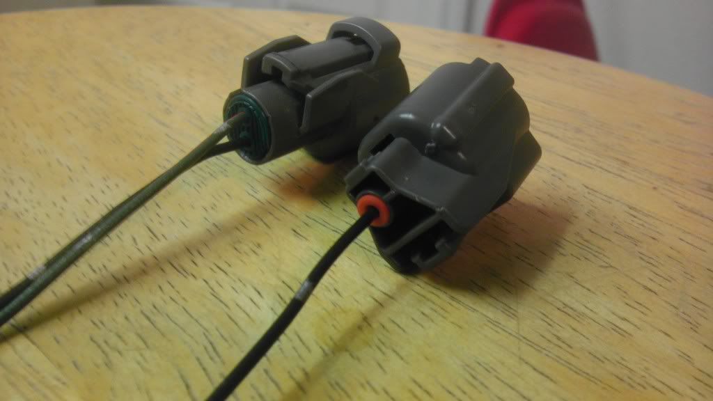

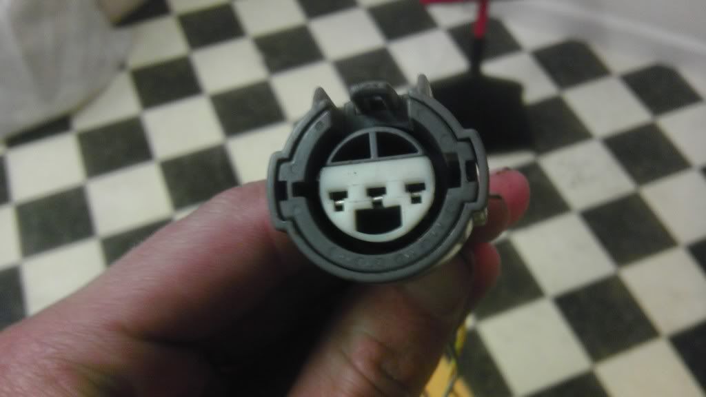

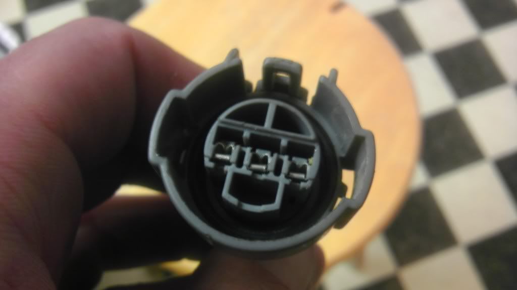

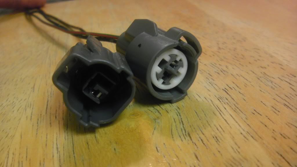

Small update for you guys… I got some OEM color matched wiring for the MAP sensor and VTEC plugs today and pinned them up.
MAP
VTEC
Time to finish up this harness!
:clap: amazing work, This is making me want to redo mine… HAHA

Colin- I was going to buy it from the guy I bought my pins from but he wanted a dollar a foot so I just grabbed it from a junkyard harness. I’m actually really pleased with how the wiring is coming out with all new pins and seals. It makes me want to repin every plug that’s visible on the harness. I may decide to but it takes a fair amount of time.

Yeah, I picked up some extra connectors and short lengths of wire from the junk yard a while back, with some simple green and scrubbing they actually came out very clean.
Yep, same here. The worst part about old connectors is they’re very brittle so depinning them can be a challenge. They cleaned up well with a toothbrush and simple green though. The only new plug I got was for the VTEC pressure switch

So far these tools have been immensely helpful (de-pinning & cleaning)
http://www.harborfreight.com/6-piece-detail-brush-set-93610.html
http://www.harborfreight.com/4-piece-pick-and-hook-set-66836.html
