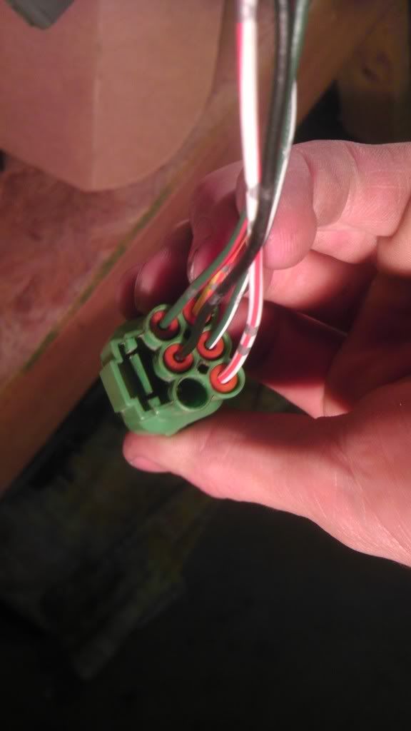

I wired up the firewall side of my MAP/VTEC subharness today. All new pins and seals on all the plugs I’m adding. I chose to use a green plug because theres already a 6 pin plug originally from the driver’s side shock tower that is almost identical and I didn’t want to have any confusion when I finally install it. It looks like I shouldn’t even have to extend the inside wires from the plug to the original MAP wiring. So all I’ll need to do is pin them and run the two VTEC wires to the ecu.

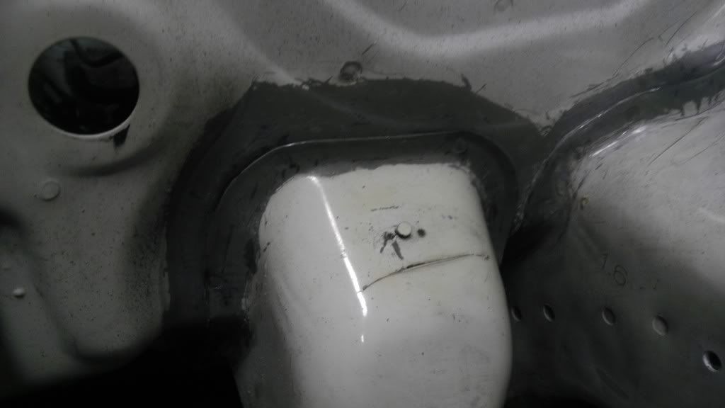

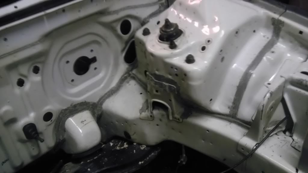

I also started removing some seam sealer from the driver’s side shock tower area.

Those seals look so… Clean! This thread keeps tempting me more and more to do something like this.

rollinmyda - great work on the wiring. your making me want to redo my whole engine harness all over again. lol Although mines will probably be a little easier since I have already made it before. would only need to make a copy and get new pins.
Thanks! The more and more time I spend looking at it the more I want to redo all the other plugs to match the new ones. It’s time consuming but I think worth it so I probably will. At the very least I’ll do the rest of the visible plugs. I’m still undecided on what type of loom I want to use anyway so I have some time.

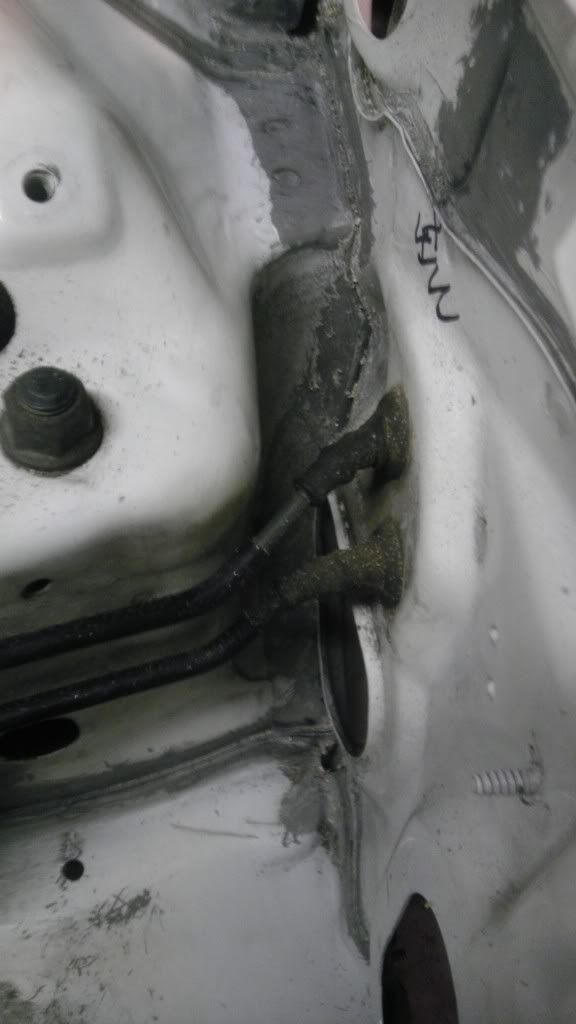

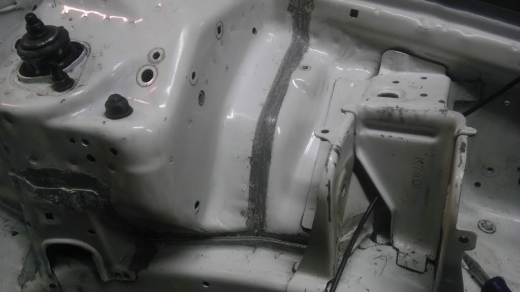

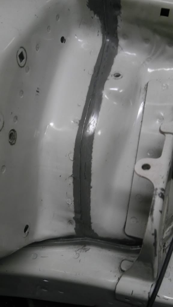

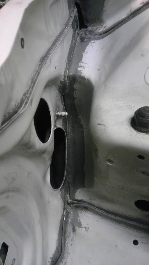

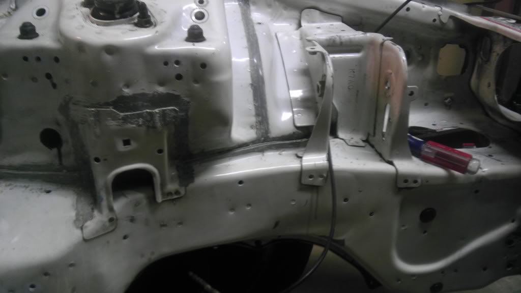

So I spent a few hours removing seam sealer today. Not much of any left in the bay. I scraped the majority off with screwdrivers and scrapers and then hit the seams with a wire wheel to clean them up all the way.
These areas are hard to reach and need some more time

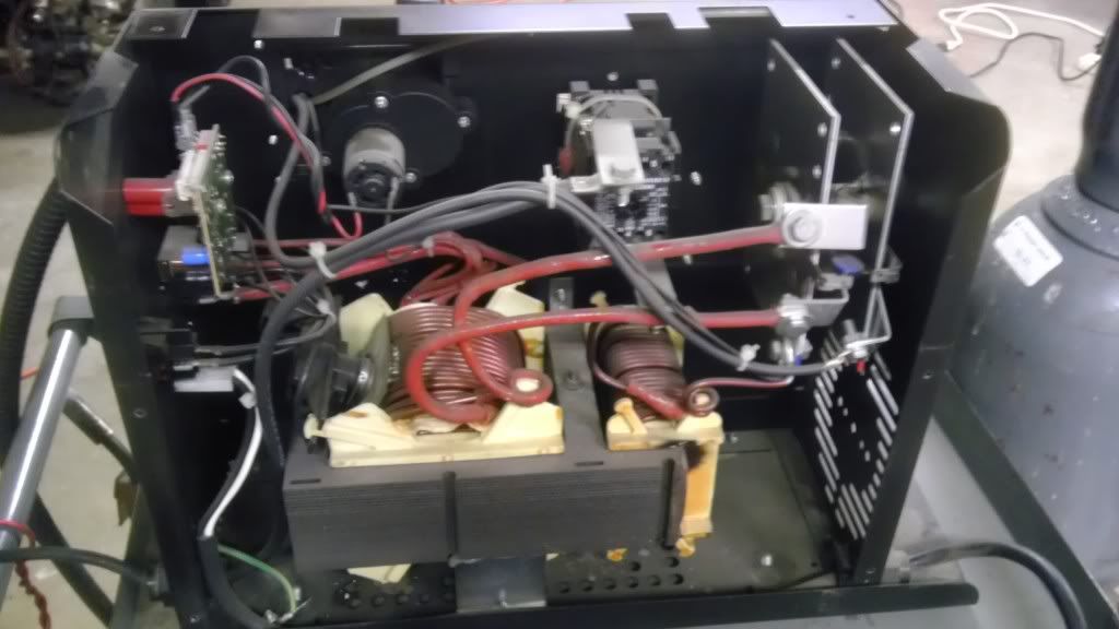

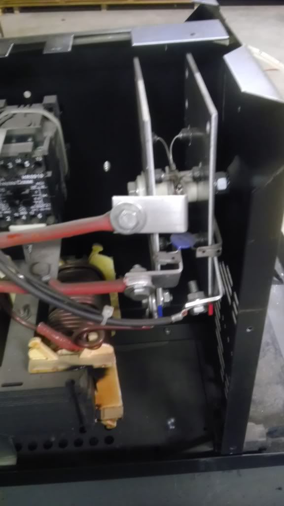

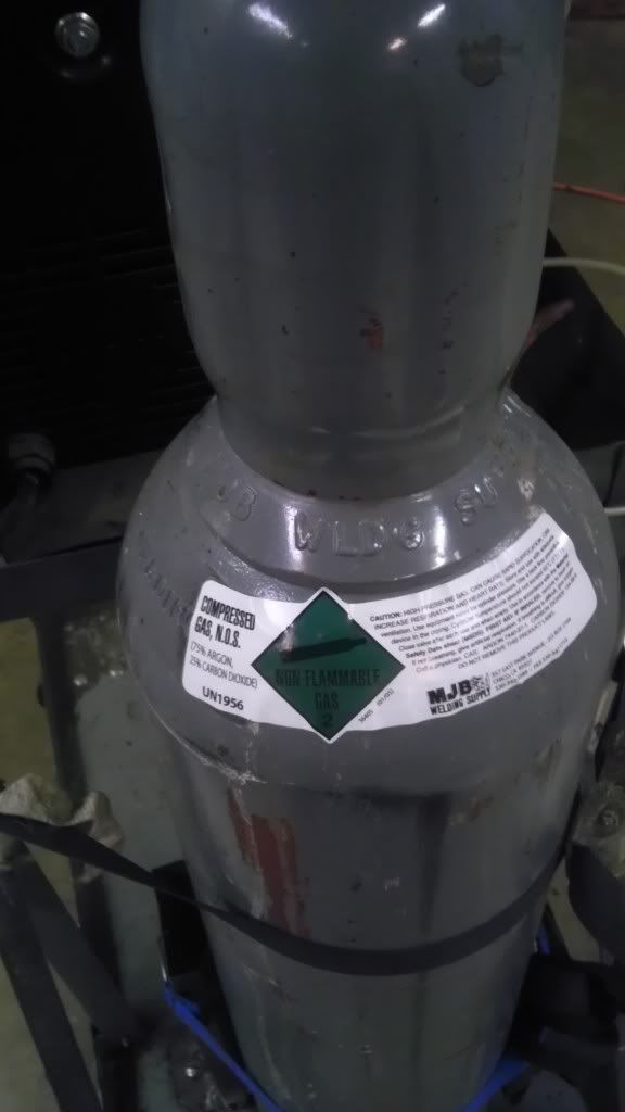

Then I went shopping to get loom to finish the harness and can’t find any large enough for what I need. I literally called and went everywhere within 30 minutes of me. So I got my welding tank filled and picked up some wire. Looks like I’m going to divert my attention to the bay while I’m stuck on the harness.
I need to figure out which wires to switch to convert to gas…

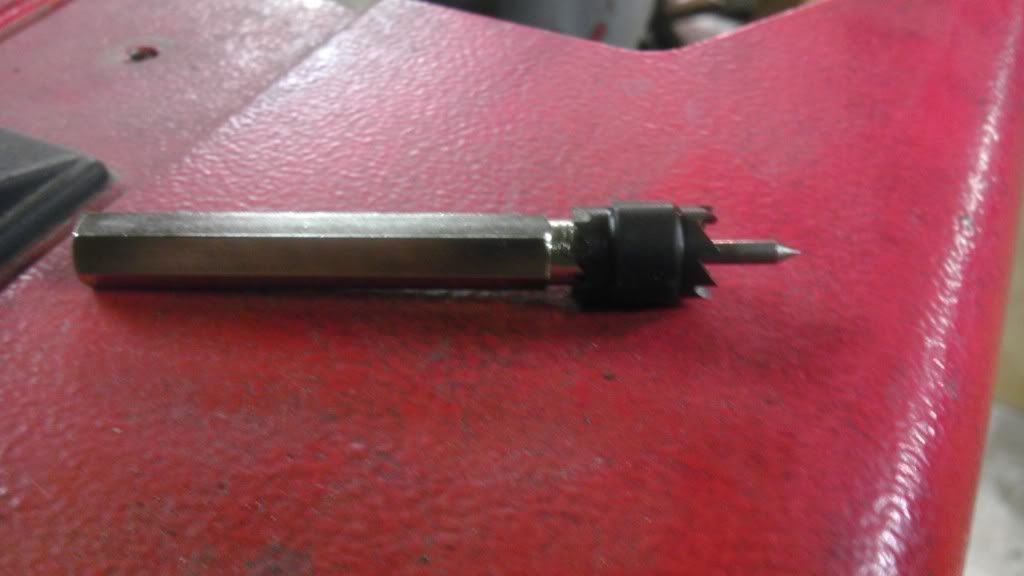

I also picked up some spot weld bits so I can remove the core support.
mike I see you’ve got a project on your hands. looking good:)
Those spotweld bits are pretty handy to have, provided your drill will keep up. I found electric was the way to go for me.
Try to only cut through the first layer of metal, and separate the sheets with a chisel… doing your best to not deform or rip anything. If you drill through both sheets of metal, its a pain to weld back together… whereas if you only drill through the first skin, you have a backing to weld to versus an open hole.
Stop with the updates already! lol It pains me knowing I won’t be working on the Integra anytime soon.
^Yup, take it easy w/ the spot weld drill till you get the hang of it. I stopped frequently to try and chisel it off or break the remaining weld that way so you didn’t drill too much into the lower material. Overall though you’ll get the hang of it if you’re paying attention.
