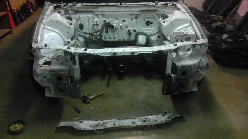

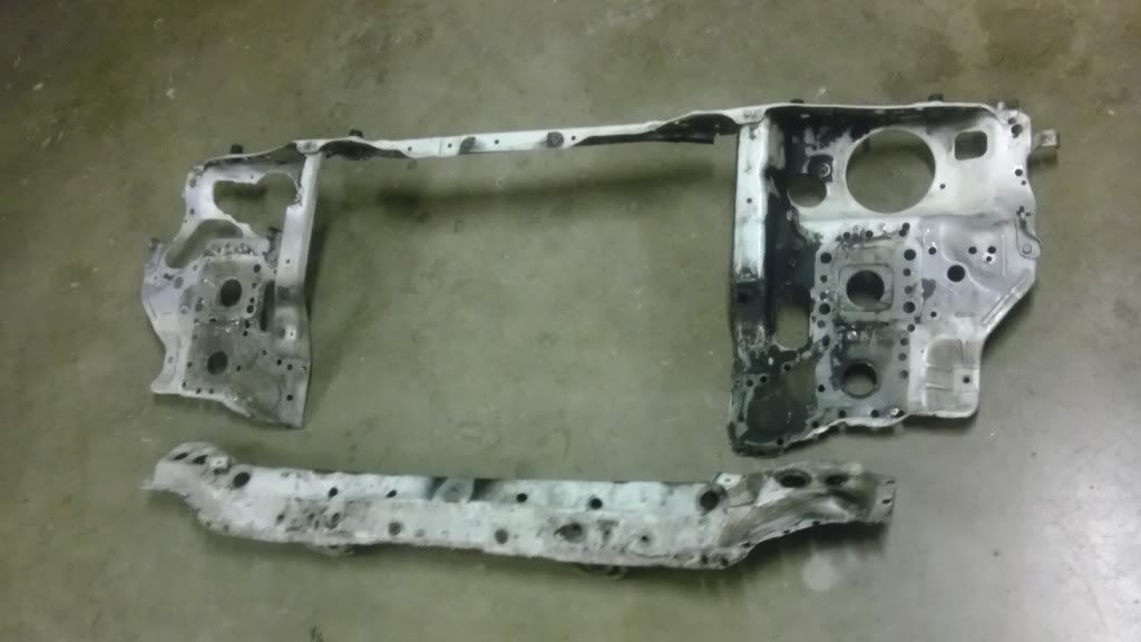

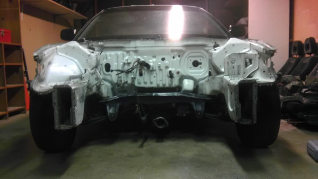

I got the radiator support out today. Went pretty smooth actually. I went all the way through on two of the spot welds but all the others came out with the original material in tact. Shouldn’t be too difficult to reinstall

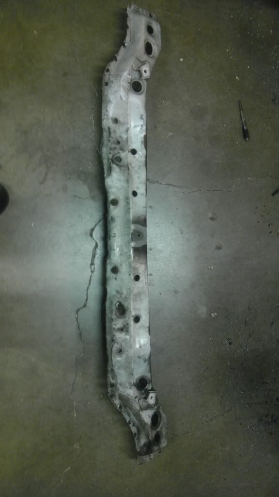

Started with the bottom section because a few welds for the sides are underneath the bottom brace.
It was in rough shape!
Then the sides and top together
YES!

I remember when mine sat with no radiator support. must have been like that for a year or so. I commend the work going into this.

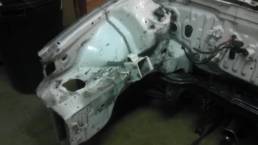

what are you going to do with the seams now that the sealer is gone? you welding it all together or leaving it with that clean break look?

I’m planning to weld and smooth them out so you would never have known they were there. I need to get my welder switched over to gas and start joining some metal!

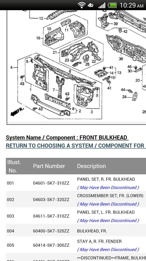

Did you buy the Bulkhead Kit from Acura?
I was just looking and the individual pieces are all listed as discontinued, but the ‘kit’ has no notation… I kinda want to replace mine now as mine looks like the previous owner used the lower as a jackpoint.
I haven’t bought it yet. I should be soon. Last time I price checked it I remember it being about $350+shipping. I don’t think I looked up each piece though, just the whole kit.

What’s the plan after you get all the seam sealer out? Stitch welding or smoothing them out?

The plan for the seams is to stich weld them and then use that self leveling and sandable seam sealer to make them unnoticeable. Some of them are pretty thick though, and I’m a bit leary of adding too much material to the bay. The last thing I want is cracks later on down the line. I just need to experiment with an area and see how invisible I can get them.

If you buy the whole radiator support “kit” does it come welded together or in pieces? Hopefully it’s still available, cause I know I bought the last lower piece left in the country about 2yrs ago.

It’s sad how quickly parts for these cars are going, so much stuff is discontinued now :frowning: I ordered from AcuraAutomotiveparts and the lower support piece arrived with some dings/dents in it due to their shitty packaging. I tried to get a replacement but they said they couldn’t because there weren’t any left in the warehouses. If the “kit” is a separate part number and isn’t just pieced together from individual parts then hopefully it’s still available.
Ugh, now you have me concerned. I don’t know if the kit comes prewelded together but if it doesn’t I guess I can safely say its discontinued. I guess I’m going to give our sponsor Dennis a call tomorrow on my lunch break and see of he can help me out.
The guy I’m going to have paint the car said he would recommend ordering an aftermarket one since they’re less than half the cost. I told him at the time that it was out of the question and I’d be ordering OEM, hopefully I don’t have to go with aftermarket pieces for something as critical as this. My front end would never line up right…
Worst case, you could yank one from a salvage yard… I too dislike the idea of an aftermarket support.
But with massaging and time you could get it all to line up. It would take some time, but entirely possible!
For the record, this is what I was seeing:
Hmm “may be discontinued”.
Yep I’m calling Dennis tomorrow

Yes, the whole front radiator support (aka the Bulkhead, FR) comes pre-welded together. I ordered one last December, so unfortunately I can’t speak on it’s current availability.
The front radiator support “kit” does contain a separate part number from the rest of the smaller pieces, so I would assume that they have some of these “kits” set aside, while the other pieces have sold “quicker” throughout the years…
I placed my order through OEMAcuraParts, this site’s parts sponsor (like you mentioned), and as of last year they still had some. But like Colin mentioned, parts are being discontinued for our cars at such an alarming rate. What’s listed today may be gone in a month or a week. :frowning:

What you’re seeing that’s discontinued are the smaller, separate pieces such as the crossmember and R/L panels. The Bulkhead, which I ordered, is still showing that it’s available for purchase. Definitely give Dennis a call to see if he has one in stock. Online parts sites can often be misleading, showing they have something “in stock” when in reality they just haven’t updated the site.
