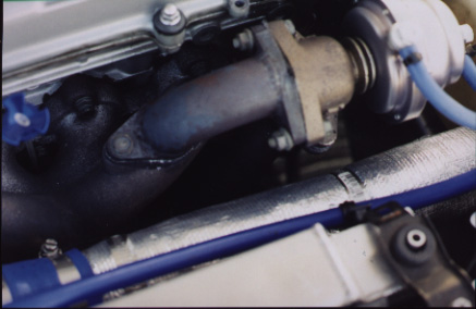

On my system we routed the charge pipe from the turbo to the intercooler through the hole that was occupied by the windshield washer resevoir. We routed the other end through the hole were the intake resonator was. It sure was nice of Honda to make these holes for us THANKS HONDA :smiley:
Sorry I don’t have any better pics of the pipe going through the hole…If you really want to see the pipe going through the hole let me know and I’ll see what I can do about getting some pics of that…
