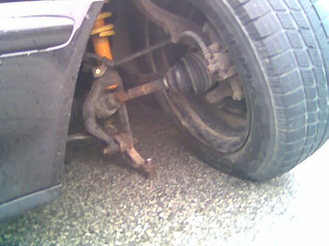

Then I had a run-in with a pothole on a sunday. Pic 3 shows the destroyed lower balljoint, driveshaft and damaged upper balljoint. The closest performance shop was able to get the skunk2 arms in for Tuesday, so I thought it would be a good time to change both upper arms.
pic 3
