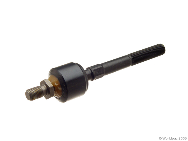

I don’t know for sure, but putting spacers would probably induce a toe-out effect which would help the car turn in quicker. This would wear out the tires quicker though. You wouldn’t need spacers to induce a toe-out on the front. It could be dialed in at the alignment shop. Here’s a pic of the inner tie rod.

no it wouldnt. thats why there are tie rod ends. After you space it. you would need to get your toe realigned. that would fix the toe out problem.
And from the picture your showing me. this would work great. A lot of FC (rx-7) guys jus put washers in there. Just be sure to put thread lock on the threads. You’ll also get more steering angle. which can allow for tighter turns. good for parking and u turns. but at full lock you may notice rubbing of the inner wheel well depending on the rim and tire size.
thanks for the pic. my question is now answered.
