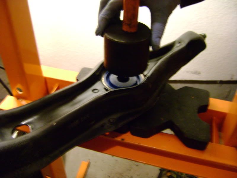

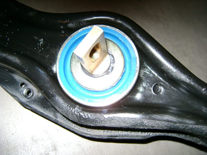

now that my curiosity has been tickled… how do u put oem trailing arm bushings? are they pressed in? or are they pressed in but with some glue? i really really don’t know.
They’re pressed in, no glue or anything,. That’s just white lithium on there:

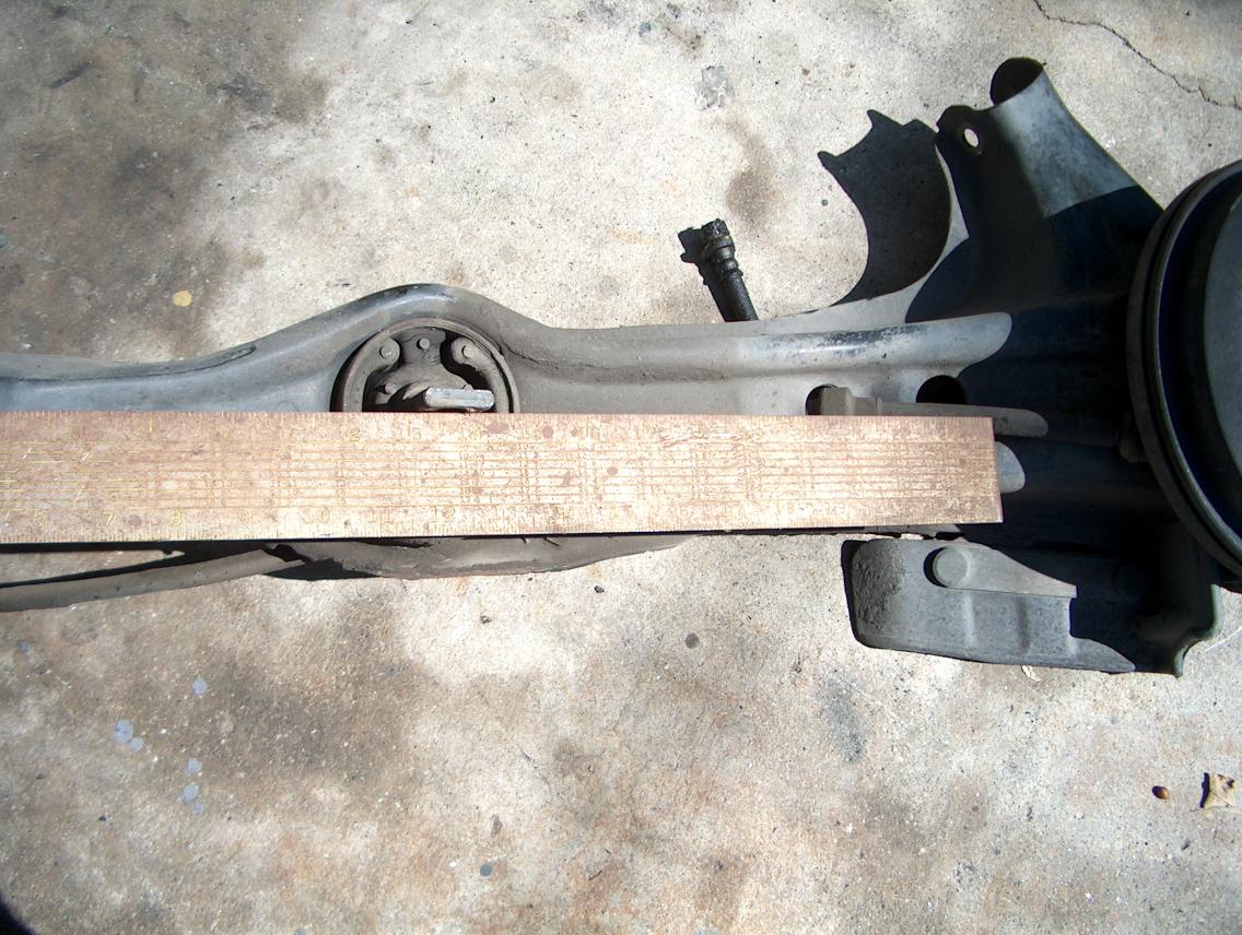

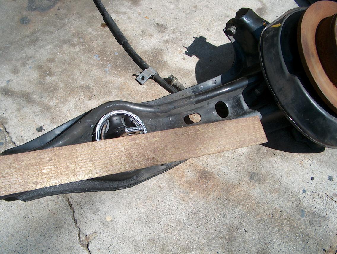

Here’s why not to use PolyUrethane back there: “In any case the [trailing arm] bushing installation must allow lateral plunge, and rotation about an axis roughly parallel to the centerline of the car, thru the range of motion (there is lateral displacement of the arm, and there IS bump steer, and there’s very little you can do about it - therefore if you don’t have allowance for plunge and said non-axial rotation, you will have binding forces). The Poly type bushing setups I’ve seen don’t adequately account for this - and you can have problems, in some cases big problems.” http://honda-tech.com/showthread.php?t=493789 also http://www.performanceforum.com/wesvann/honda/bushing/bushing.html
Stock height:
Lowered
curious. so is that an oem TA bushing? asking due to color of the rubber and it not looking like the ones in the pics of the oem ones in the links u provided.
I’ve researched and feel that the Mugen Rear Trailing Arm Replacement bushing is probably the best route for me.
