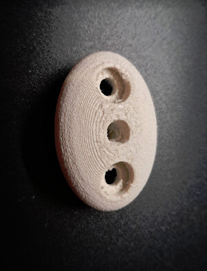

Printing now.
Snapped when removing the support :frowning:
Will try again with a different support structure.
I’m trying to imagine how you printed it that it would snap when just removing the support. It looks like it would be a solid chuck of plastic. There must be some nuance of the part that I’m not aware of.
Depending on the support type, it could be difficult. Sometimes I need to use a blade to wiggle it free. If I slip, it breaks. There’s an art to using supports and getting them off. I’m not too experienced in dealing with the nylon stuff so it’ll get better as I keep honing the skills.
It’s pretty rough. I’m going to install it anyway to see how it does. The 0.6mm nozzle just isn’t as smooth but this material is considerably stronger.
You probably already know this, but have you tried changing the support interface distance so it’s “further away” but really just touching the print a tiny bit less? Tweaking this for PLA prints made my supports a lot easier to pop off
I have. The PA6 material is just difficult to work with. If I put that separation distance too high, I get slumping. There’s a balance there I just haven’t figured out yet.
