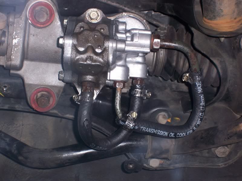

When you loop lines, you gotta do it the proper way or else the system will continue to try to pressurize the lines a bit thus soemtiesm leaking from looped lines. On my car I removed EVERYTHING minus the PS rack. Looped the speed sensor, took apart and gutted most of the valve body, then looped the 4 fittings intot eh corrseponding ones depending on flow, and the high rpessure hose I “T” in a breather. with the breather mod etc, the rack is amost as easy as a real manual rack.

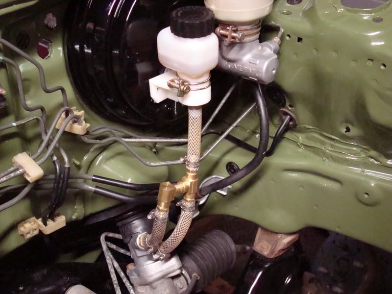

does anyone have a pic of the looped lines with the breather in it. aslo is this going to be ok on a daily driver?
what kind or kinds of breather setup are people using. Please post your pic(s) of this mod.
Dont have a breater setup up on mine yet, but here is a picture of my looping setup.

looping the lines

yes, both, definately. i dont understand why you would go to the trouble to take the rack out and flush the fluid and gut the valve body if you werent gonna loop the lines. i also dont understand why you would go to the trouble to take ps removal so far as to get to this stage just to leave the rack in the car and just loop the lines. when mark and converted the first ps racks years ago we designed them like that for a reason. looping the lines assures that the fluid is flowing to the right places in the right direction and the rack would work properly if the valvebody were intact. gutting the valvebody assures that there is little to no pressure generated by operating the rack. even when the fluid circuits are opened up, you still want it flowing in the right path. you cant just loop whatever hoses you want. the two mods go hand in hand. its not a matter of whether or not it works using either one of those methods alone, its a matter of doing it right if you are going to do it at all, which entails doing it completely, (by performing both rack mods to achieve the least felt pressure at the wheel).

lol damnit man why wont they just do it the right way? i also dont want someone halfassing the process and then blaming it on the method when it was in fact the incompete execution. im just trying to help in my own sorta technical, verbose sort of way. ha! laid, schmaid… who needs that when i got the money tree?
saw that pic on another forum and thought i’d post it here to give people ideas.
sombody should open a “how to put it back on” thread, mine was removed but i want it back up …
follow the steps in reverse. :up:
Kyle–that pic probably gives people a start, but that p/s rack is really unlike the g2’s
i wasnt sure if there was much of a difference. i still like the idea though. i’d like to see it on a DA. there are still just as many hoses, right?
i had it for about 2 weeks on a DA and it was both invasive in the engine bay and honestly not all that special. no real noticeable difference between removing the valve body parts and putting in a breather.
