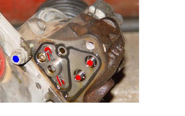

^^^ If you are referring to Swedboy’s write-up then I would like to see it too. Unfortunately, I read the first and last page of this thread which indicates to remove ALL of the parts from the valve body and that’s what I did. Now it looks like I have to put some of the parts of the valve body back together in order to make it work properly :bang:
I downloaded the document Phantisy uploaded and it looks like that is NOT the correct way of doing it since that document clearly states to remove a total of 11 parts from the valve body. About half way through this thread Swedboy posted a link to re-assemble some of those parts taken out of the valve body to fix some issues some people were having.
You do not remove all the parts in the valve body. The document I have posted is not one I made. It was one from this thread and was sent to me in an email. I will get back to you in a few with a pic of what to remove.
If you remove all the parts there will be play in your steering. I tried it by removing all the parts and it was awful.
Thanks Phantisy!! I’ll wait for your picture… Yes, I know you didn’t make the document, but that’s what threw me off because the write up on the first page says to remove all the components from the valve body then the document you uploaded for everyone to use has basically the same information. It’s not your fault, it is my fault for not reading the whole thread. I went back and read it after I did the mod and that’s when I found Sweadboy’s write-up… The problem is that his write-up is about half way through this thread so people will HAVE to read the whole thread to realize that otherwise they will make the same mistake I did…
if anybody has any pics on how to gut the valve body the correct way please post or e-mail me at rayrayb20t@yahoo.com i jus purchased a new rack and before i put it in i would like to do it the correct way. thanks
Can someone post up the correct pic of what needs to be removed?
Phantisy said he was going to post one, but he never did… :frowning: I’ve been waiting for this…

Yea i removed all that crap inside there now mysteering wheel has hella play. WTF?
Can someone clear up what needs to be removed?? Maybe start a new thread thats not so misleading?
Remove just the 2 plungers & springs on the right do not remove the 2 with the bar across them. Thats the way mine was done a few days ago & it seems fine.
^ thanks going to try this tonight. going to let you guys know if it works for me.
