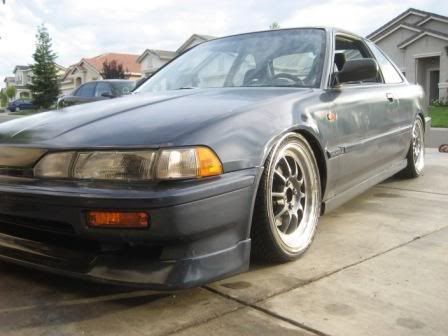

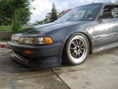

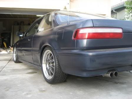

heres pics of the car and stance
this is an autocross monster. and really fun in the mountains.
