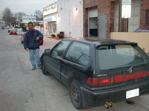

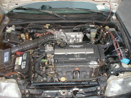

now before u start talking crap, about i do not know what i am saying…here r pics of my B16 powered 1991 civic si b4 i sold it it has full exhaust, and intake, cams,Fields controller, and DC headers…and little extras
*if link dosn’t work…copy and paste url.
now this was my first on only B16 swap…
and i have been through 5 swaps!!!..
personally…i will NEVER go back to a 1.6L motor…
sorry…
