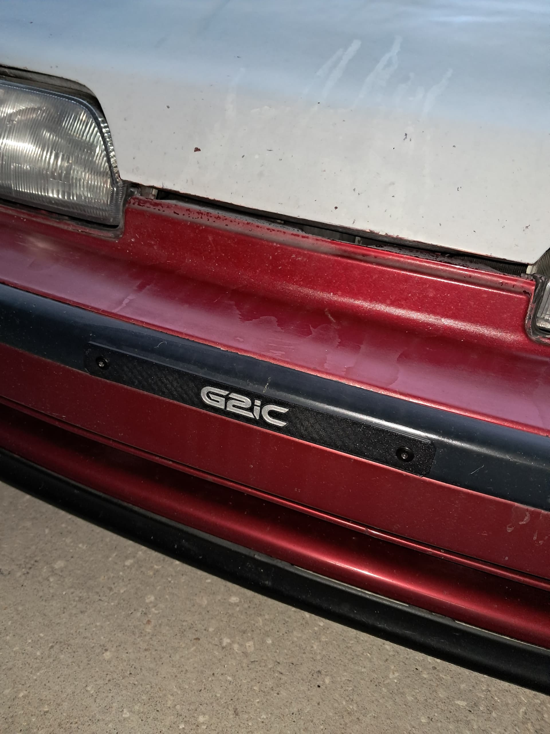

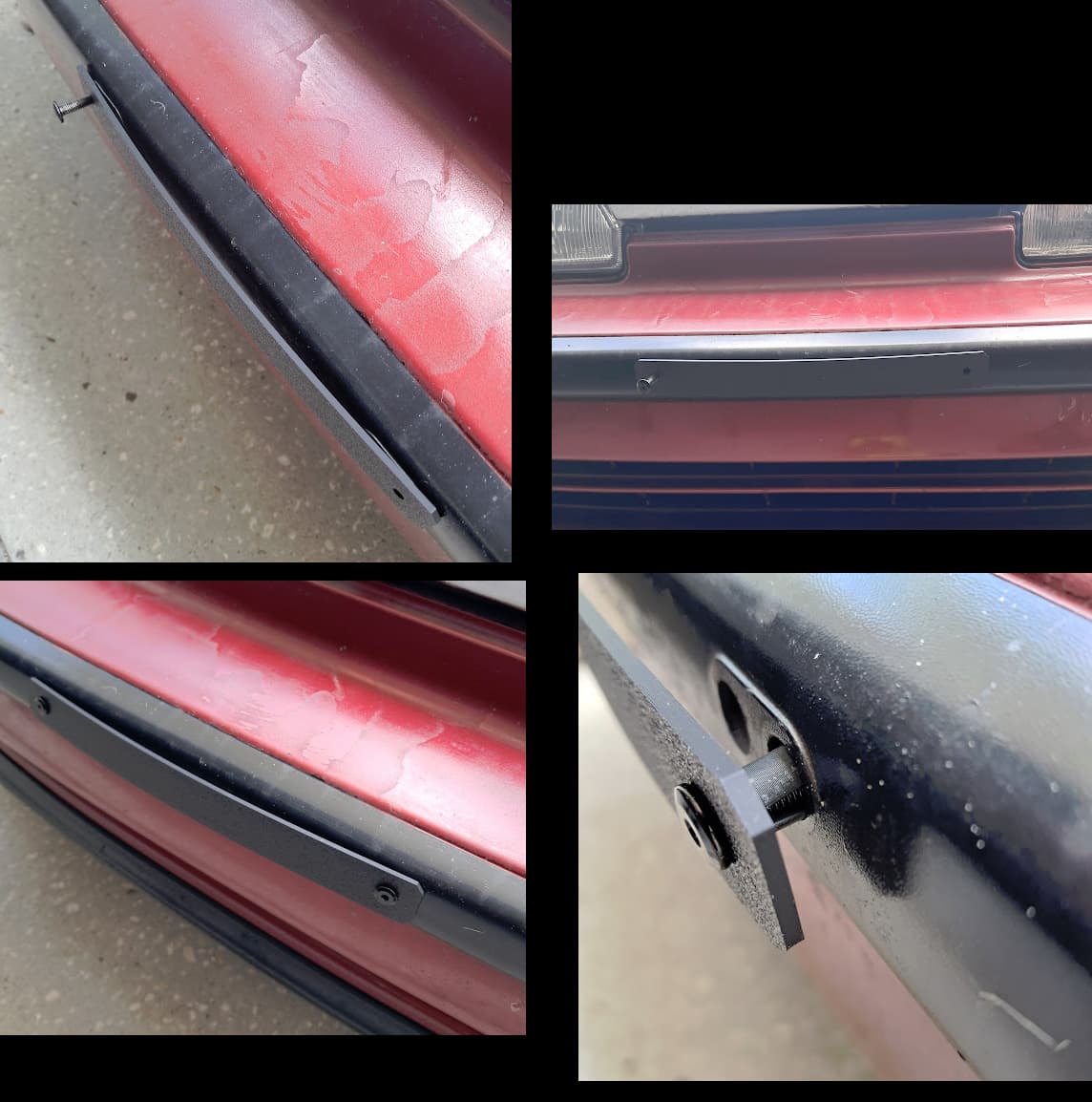

For us lucky enough to not have to use the front license plate.
For when you don’t like the OEM style front bumper license plate hole covers.
Option available to get your username embossed instead of “G2IC”.
Currently test fitting. Looking at options for “locking” screws.

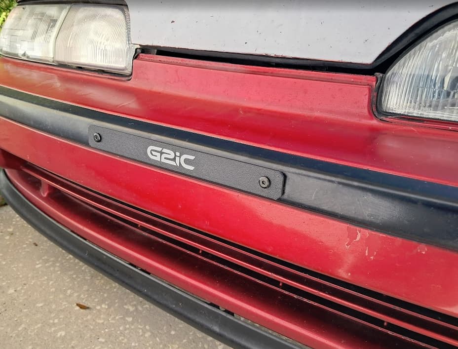

This will probably be in a 2-color format, not the “emboss” shown here (unless by request).
Secure screws are out – it’s too pricey to get the tool in bulk. I’ll stick with black hex.

The screws do not work properly. I need to use a different design.

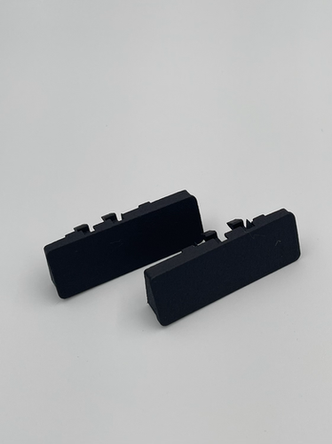

Ninety93 3d prints these now, both styles. The 92/93 clip in.
Yup I bought a pair. The “NOTE” is because of me LOL

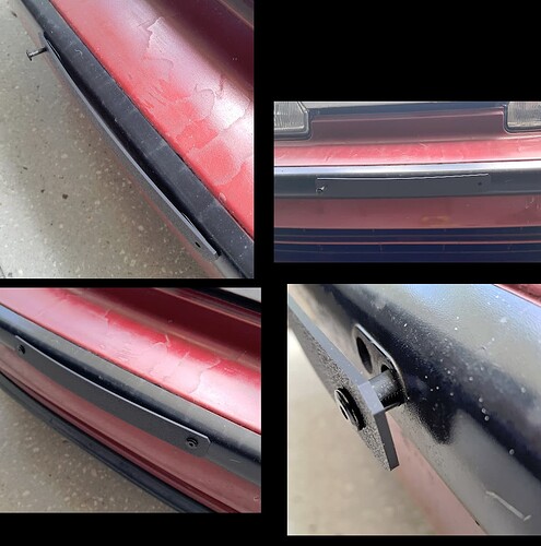

I’ve never had so many issues finding a decent well-nut that fits into the bumper that also holds the plate. It’s nuts. I’m going to have to design it with built-in expanding arms so I don’t end up with this massive “plug” on the front. It looks bad.

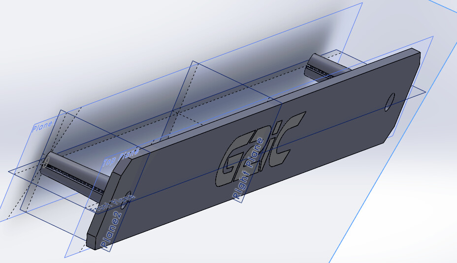

Modeling the version with integrated anchors.

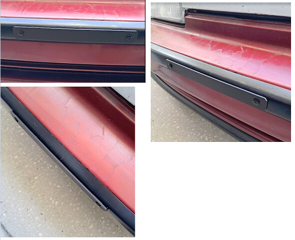

Have a winner.
Will reprint with ABS and ride with it for a few weeks for testing in the Florida sun.
NFULFX
July 20, 2025, 12:20pm
15
Installed the ABS version. Will report status in about 1-2 weeks.
(Oof, I gotta adjust that foglight alignment.)
