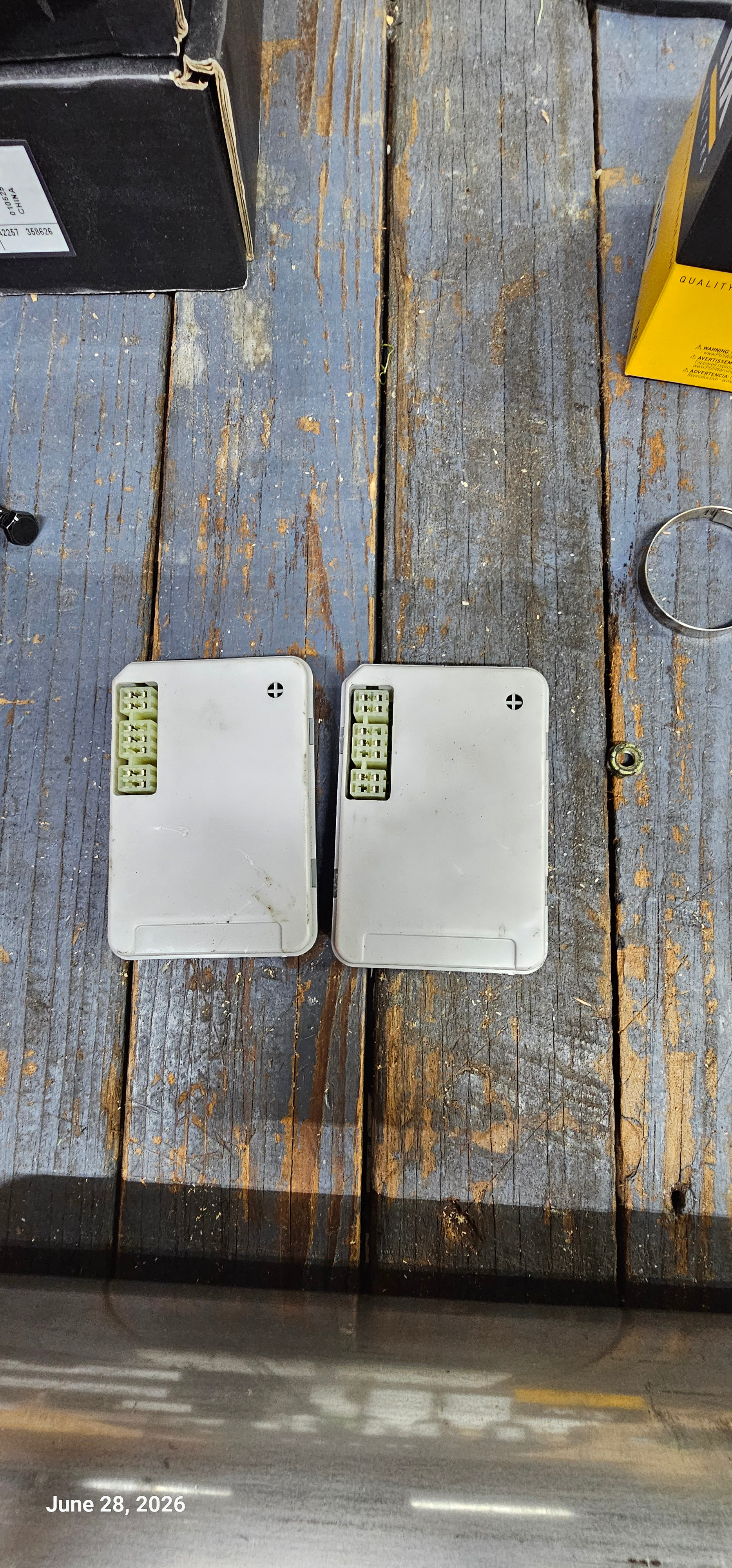

would like to try this out i have a few icu I can send plus the one out of the car.
I have ordered the parts for the second batch. I was really hoping for more feedback from folks that purchased the first batch but life happens and only 2 of the 5 folks that purchased them have found time to install them, so I am cautiously moving forward with a second batch. I plan to have them available in mid July. I will definitely be needing the connectors and cases from the old ICUs so thank you for that. Obviously don’t send me a good working ICU.

They are not good working ones. I will trade them off to you. I would like to try one out. Im having trouble with the seatbelt warning going off. I have found some info that the icu has something to do with it. Also having flasher not working and no rear defrost.
The ICU does not handle seat belts in a second gen Integra. There is a separate seat belt module. Front corner flashers are the only flashers related to the ICU. Rear defog relay is activated by the ICU but the problem could also be the relay it self or even the defog switch. Worst case scenario is the grid in the rear glass may be damaged.
