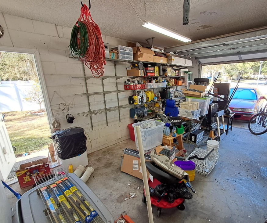

With Monday being a holiday for me, I’m going to try fitment. I’ve been cleaning out the garage to get access to my parts. . .

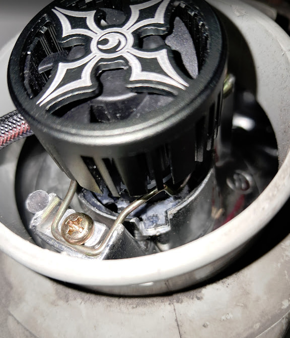

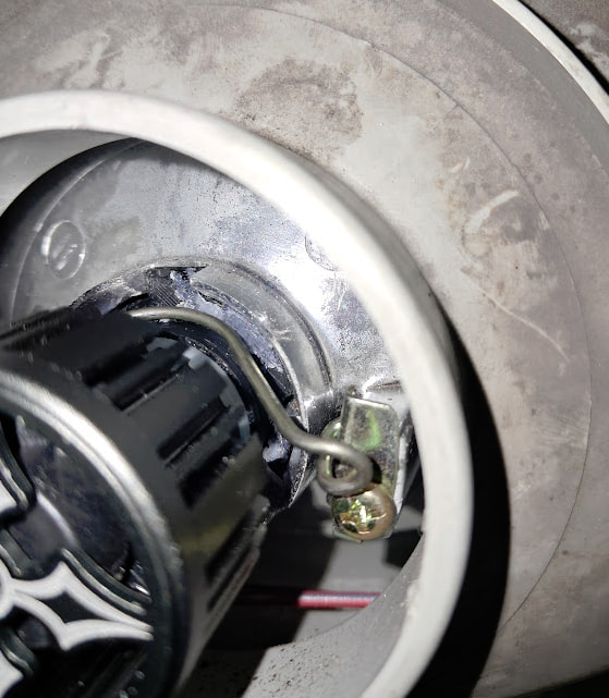

Well, it fits within the spring retainer without much effort. We’ll see how it holds up to the heat.

After a couple weeks of extremely hard driving (30 hour road trip (around 2,000 miles) with only stops for gas + very hard mountain driving // daily 40 mile commute to work at 100 mph) I,can say with my entire chest these are great they havmt melted or anything of the sort. The only tiny issue i had was that they were too tight out of the box so I just filed them down a little (it only took 30 minutes for both going very slow) which is no problem at all for me as it insured a very tight fit that gives me peace of mind that it won’t move (and it hasn’t). 10/10 review from me i would 100% buy another set.
@wesecuring Thanks! I had no idea you’d put it through that sort of abuse. From what I can gather from your post, it can withstand the engine temperatures, but I don’t know how much heat you’re currently pushing through there and also what kind of vibration it was subjected to.
