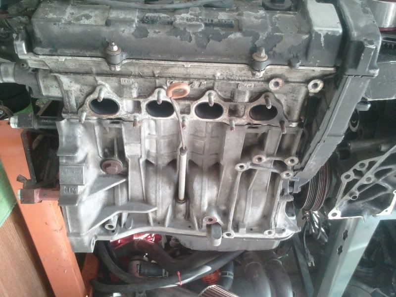

does anybody know where tha green plug in the pic goes too? thanx
looks like the oil pressure sending unit. If you have a ls/vtec, even though this is off topic, it might be where your oil for vtec is coming from. If so then you need a T fitting so you can put the sensor back on. Just my educated guess cause the green plug on the back of my block goes to the sending unit just below the alternator.
You can see his Oil pressure switch at the end of the steel braided line and its only a 1 wire connect. The Green plug is for the Oil Temp switch which is located to the left just above the Oil pressure switch.
ok thanx guys , i look for that tommorow i didnt see where it goes to but i look again

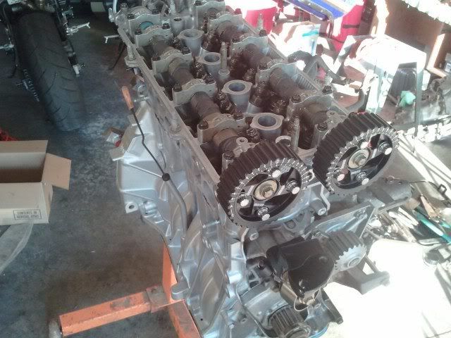

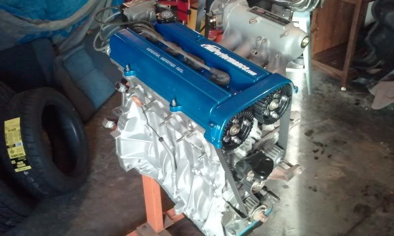

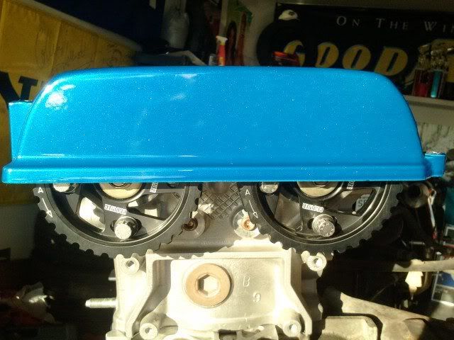

old setup: From this

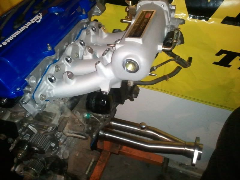

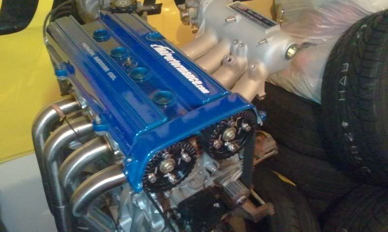

To this…stock bottom, crower 403 cams, blox intake maniold, TDM hytech replica header
new setup : crower 403 cams, rs machine type r pistons, blox intake mani, tdm hytech header, valve job and milled 0.030…l’m lookin for 165-170whp and 125-130TQ

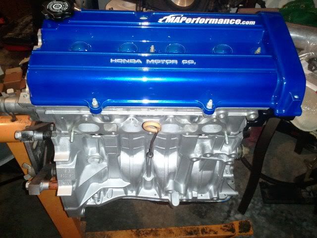

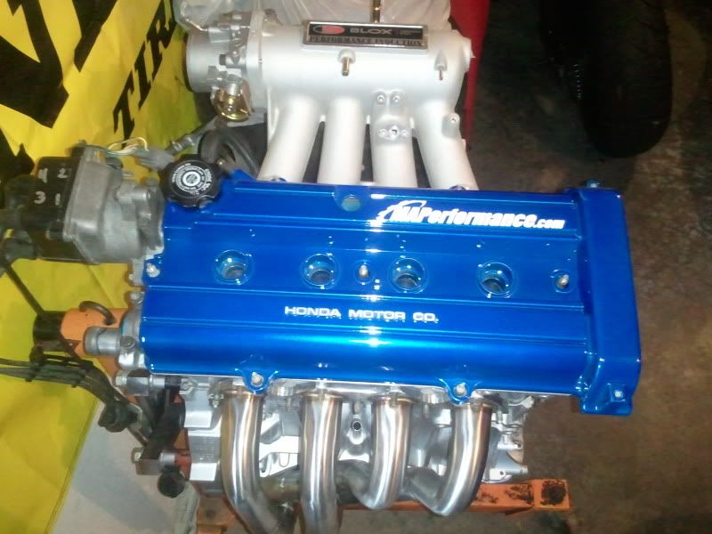

I do not know my HP potential but I’m building a ls b18b rebuild so far
Sk2 intake Mani
68 mm Holley tb
Sk2 adj can gears
Complete brain Crower head: valves, dual springs, titanium retainers, 402 NA cams
Block has had fresh rehone
Parts I still need
Aftermarket rods
Head basket set
Then my daily will be ready for the swap
